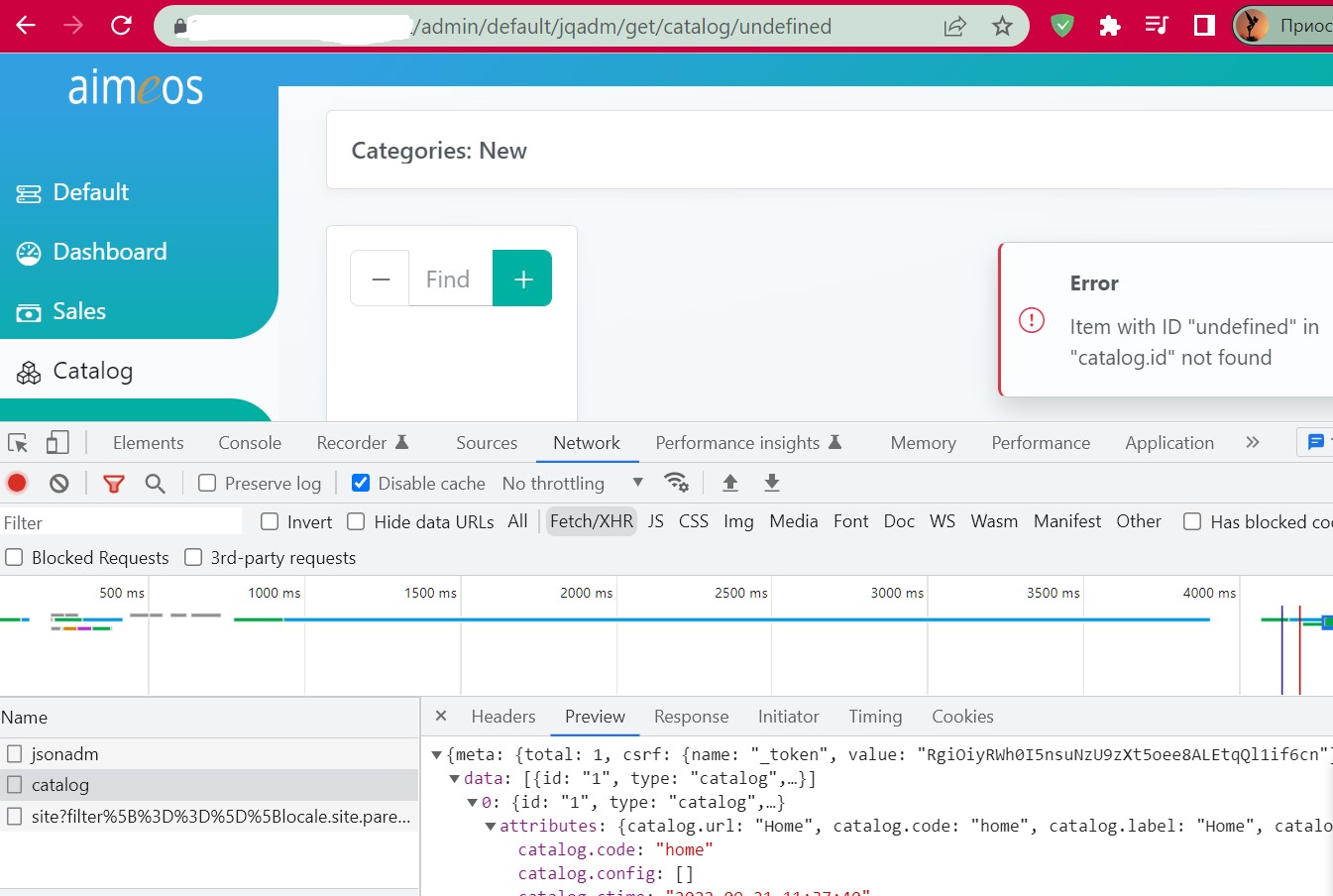

At production instance categories page admin 'Home' category doesn't show as usual.
While click at it - error "Item with ID "undefined" in "catalog.id" not found"
And at json massive at structure got 0 element (while at local version no 0 element and everything is normal).

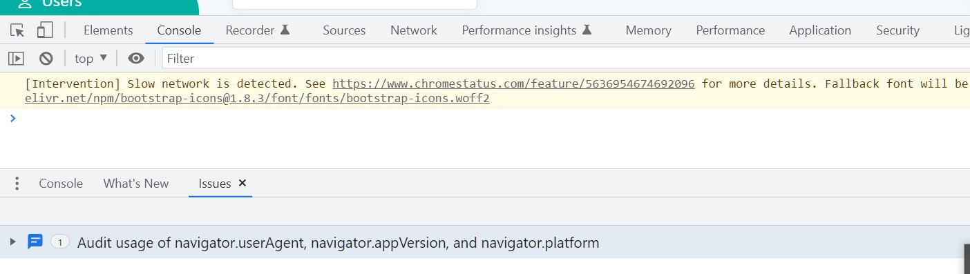

Is there any JS error in the browser console before or after the error?

No any js error at console.

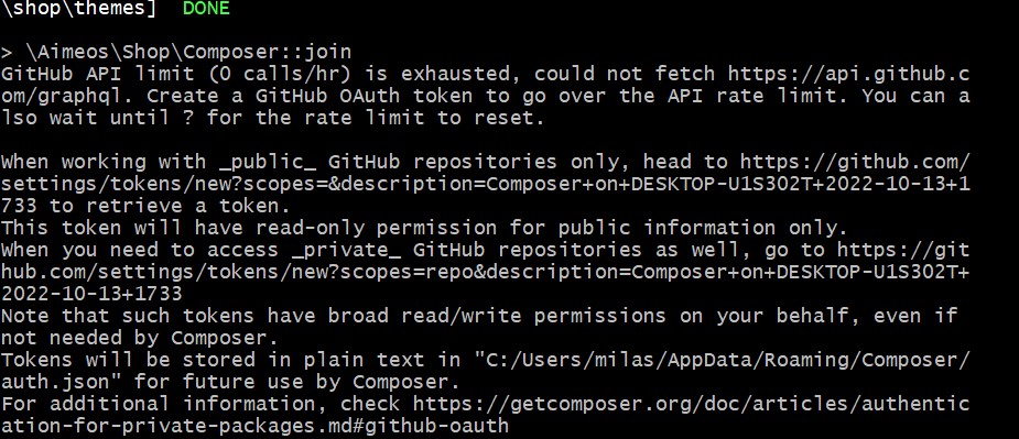

While now try to upgrade version there was this about github token and can't to finish upgrade (attch login error after try upgrade)

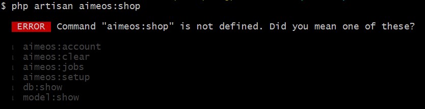

You have to run "php artisan aimeos:shop" to upgrade the table structure

Try to run "php artisan aimeos:shop" but no this command

Sorry, it must be:
php artisan aimeos:setup

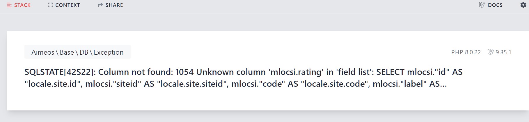

Thank you, run
command work without error - but now login page not work 404
