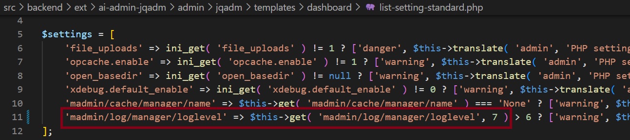

Enable debug logging (madmin/log/manager/loglevel = 7) and check the generated SQL statement to see what happens.

I am not sure where to set the loglevel = 7. Is that correct?

The config is in your ./config/shop.php file:
https://github.com/aimeos/aimeos/blob/m ... p.php#L196
Even if there's no error, you need to see what SQL statement is generated to find out why the "=~" operator isn't behaving as expected.
