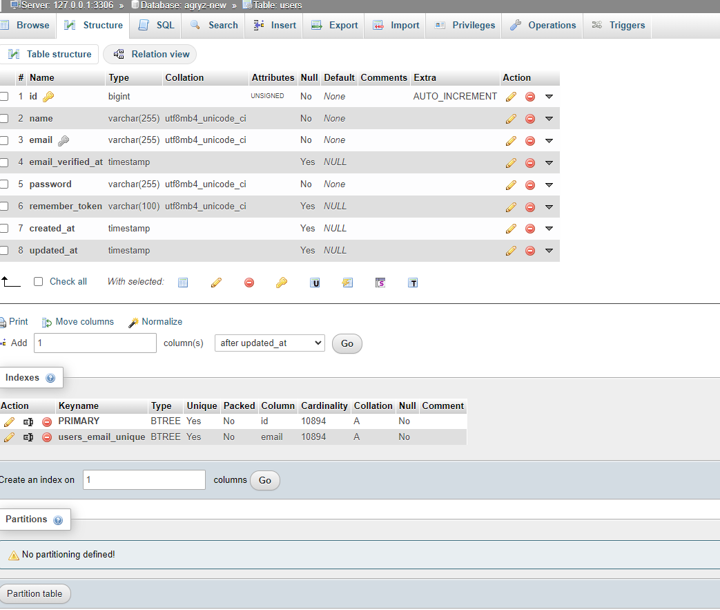

Re: Unknown database type enum requested
We haven't seen that before but maybe you are using an ENUM column type in your existing Laravel "users" table which Doctrine can't handle?
Is there an ENUM column anywhere else in your database tables?
Yes, I have one.
Why Aimeos installation command changes it?
Сan I somehow avoid it?
- unnamed1.png (103.48 KiB) Viewed 12143 times
It's not Aimeos, Doctrine DBAL (which we use for schema updates) parses the complete database schema and don't understand the ENUM data type:
https://www.doctrine-project.org/projec ... html#types
