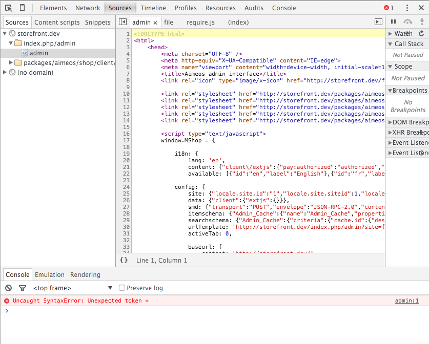

As I mentioned, fixing that error created a new error. I still only get the Loading... square. Not I get an error related to the actual HTML in the response.
See attached screenshot...
Uncaught SyntaxError: Unexpected token < admin:1- Attachments

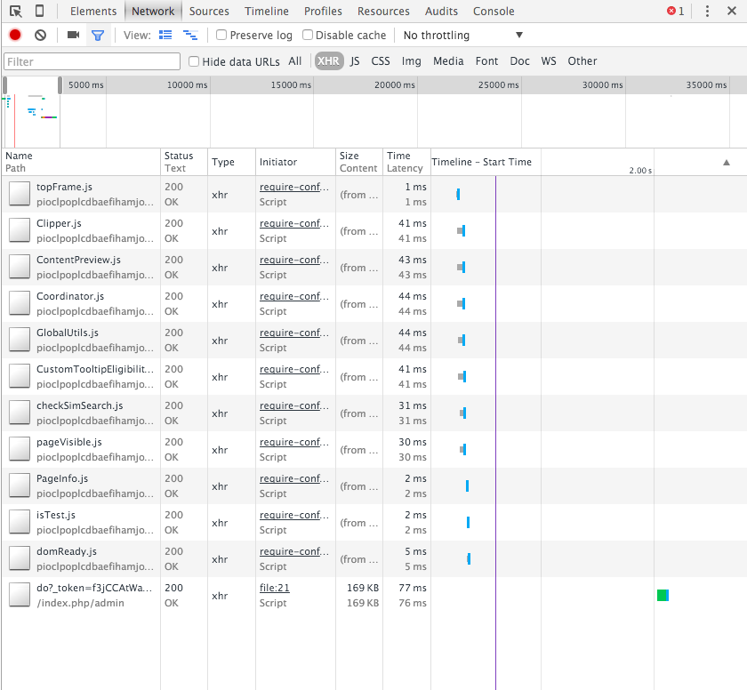

Something seems to be really messed up. Can you make a screenshot of the loaded URLs in the "Network" tab from the Chrome developer tools, please?swpierce wrote:Code: Select all

I attached a screenshot of the XHR requests. I can grab the other requests also if needed - 80 total.

- Screen Shot 2015-11-03 at 6.45.24 AM.png (139.45 KiB) Viewed 22732 times
Re: Admin interface stuck?
There are a lot of XHR request that are not related to Aimeos. Did you've integrated it into another application? If yes, could you please make a setup of Laravel/Aimeos only first?swpierce wrote:I attached a screenshot of the XHR requests. I can grab the other requests also if needed - 80 total
The only Aimeos XHR request is "index.php/admin/do". If it returns the index page, then the wrong URL is fetched internally (either due to the web server or the Laravel application).
