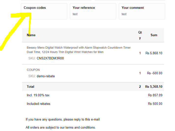

coupon code is not showing in order/payment email
Post by VirtualSpy » 04 May 2023, 08:01
laravel version 9.48.0 , Aimeos version 2022.10.4 and PHP version 8.1.3 (Win)
src code
$basket = $order->getBaseItem();
$view->summaryBasket = $basket;

please tell me what is wrong there.

Is the coupon code shown in the checkout/confirm page after the payment?

'order/base/coupon' was missing in my version in payment and delivery both
$domains = ['order/base', 'order/base/address', 'order/base/product', 'order/base/service', 'order/base/coupon'];
https://github.com/aimeos/ai-controller ... d.php#L224
