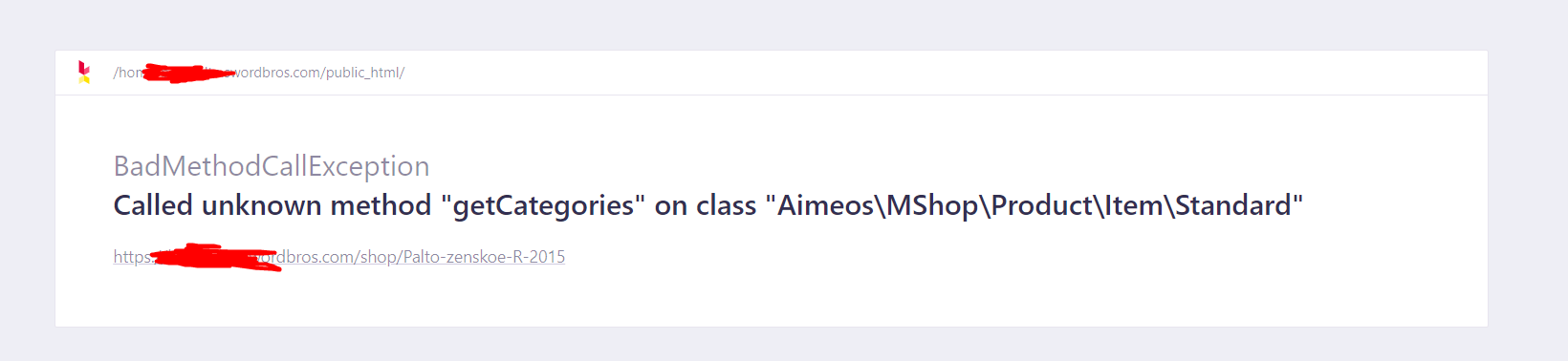

How this works on 2022.x?
Thanks
Re: category name in the catalog detail page
Post by aimeos » 02 Feb 2023, 13:35
Category references move from mshop_catalog_list to mshop_product_list table and you can now use:
$product->getRefItems( 'catalog' );
Make sure, the categories are fetched by the manager with the correct domains.
