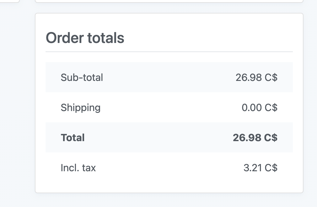

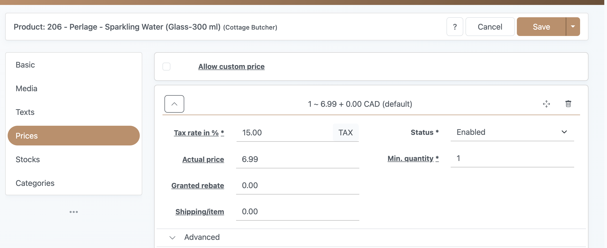

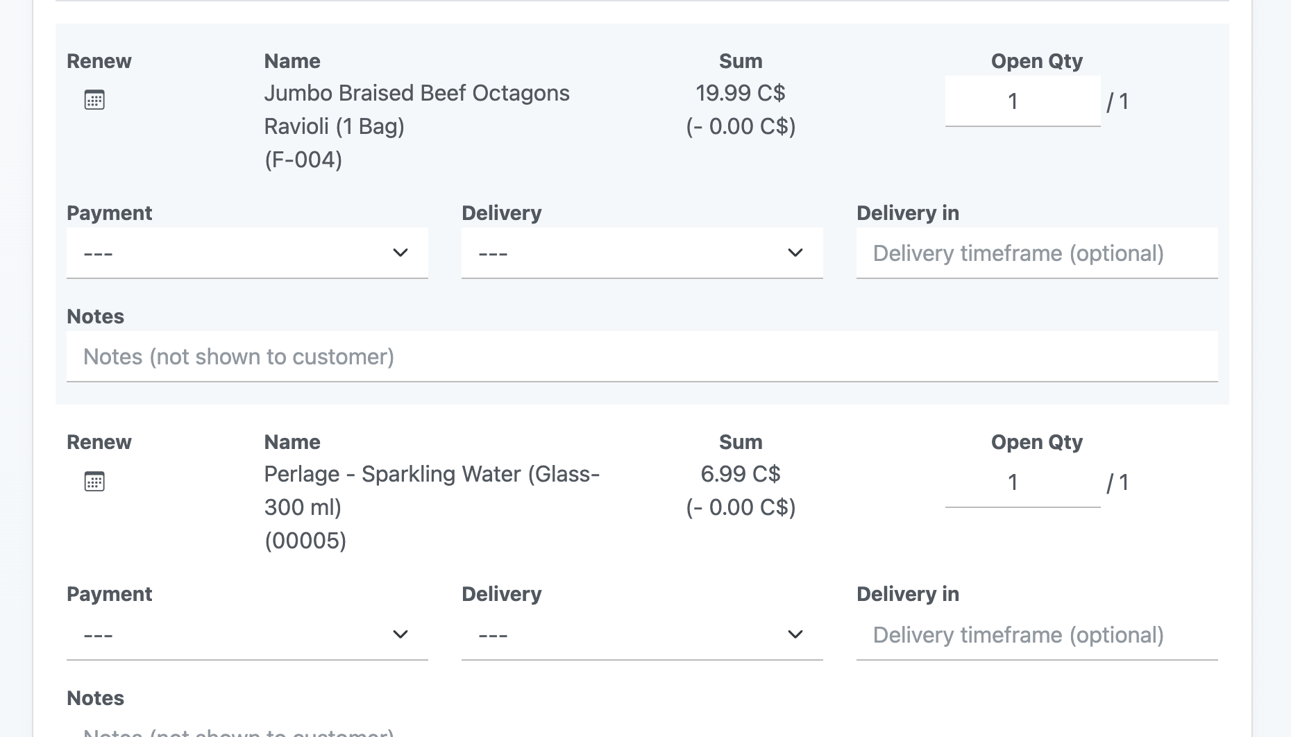

I would like to seek clarification on how the order payment is calculated. I have two products: "Perlage - Sparkling Water (Glass-300 ml)" priced at $6.99 with a tax rate of 15%, and "Jumbo Braised Beef Octagons Ravioli (1 Bag)" priced at $19.99 with a tax rate of 13%.
According to my calculations, the tax for the first product would amount to $1.05 (6.99 * 0.15 = 1.0485 ≈ 1.05), while for the second product, it would be $2.60 (19.99 * 0.13 = 2.5997 ≈ 2.60).
Thus, the grand total amount, inclusive of taxes, should be (6.99 + 1.05) + (19.99 + 2.60) = $31.63, with a total tax amount of $3.65 (1.05 + 2.60).
However, in your order description, it indicates a total of $26.98 with a tax amount of $3.21, summing up to $30.19. This seems to deviate from the calculated total.
I kindly request you to provide further information and attach any relevant screenshots to aid in resolving this discrepancy.

The calculation in Aimeos is correct because your prices are gross prices which already include the tax. The net total would be 26.98 - 3.21.
If you want to use net prices instead, use the "mshop/price/taxflag = 0" config option.
