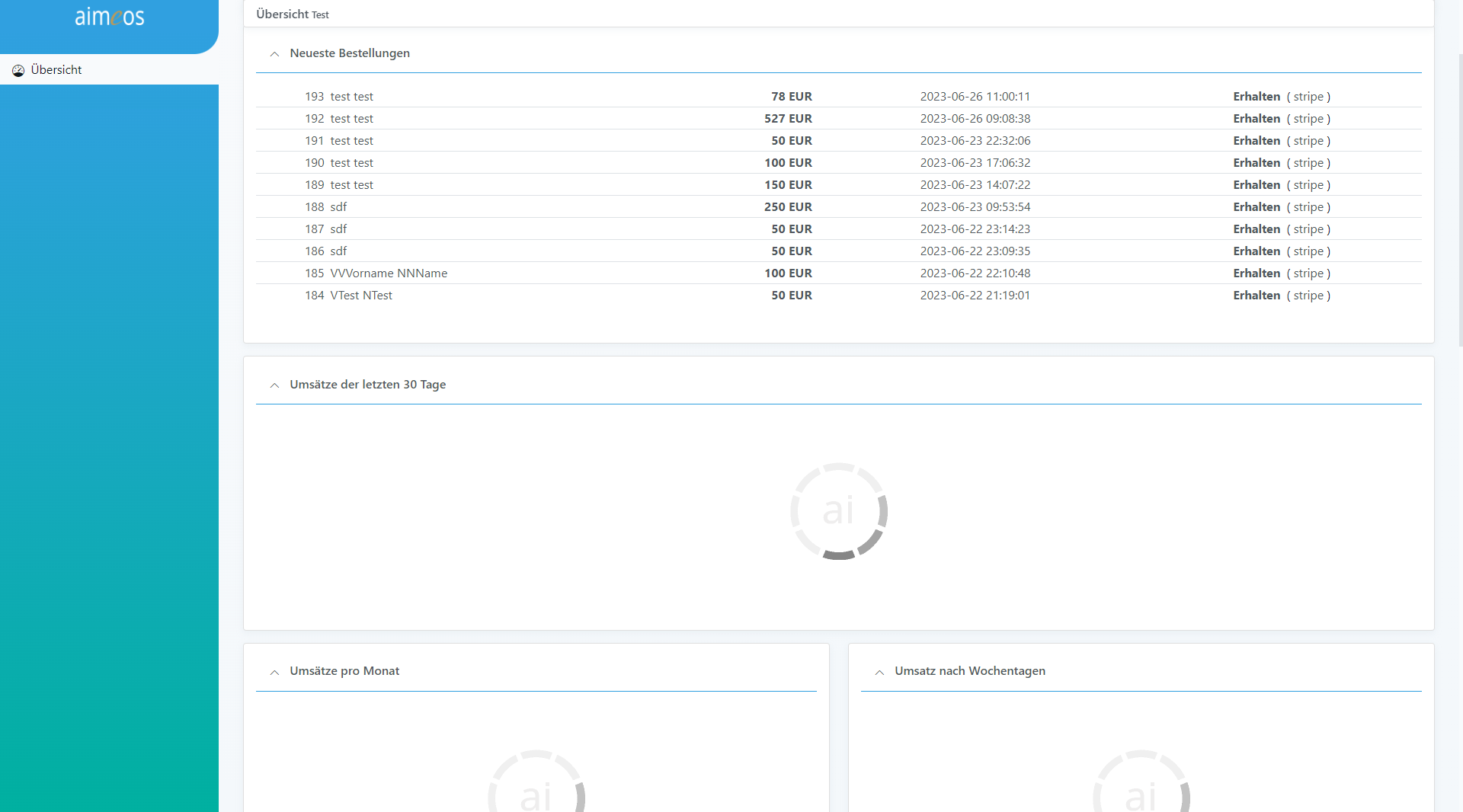

nowrap
Posts: 37
Joined: 01 Mar 2023, 23:03
Re: new group privileges
Post by nowrap » 27 Jun 2023, 21:22
Thx for your reply.
I added the other groups to the config/shop.php but this doesn't change the behaviour to automatically navigate to the admin dashboard view. It opens the /profile page.
The request to /admin/default/jsonadm?locale=de is an options request. I tried to follow the source code to find the origin of the exception for the 403 response. It's the JsonadmController.php in method optionsAction:
https://github.com/aimeos/aimeos-larave ... r.php#L116
There the groups seems to be hardcoded?
$this->authorize( 'admin', [JsonadmController::class, ['admin', 'editor', 'api']] );
For testing i added my new group. After this the request finishes. But i still have a lot of spinning icons. Only the newest orders are presented correctly.
Regards
