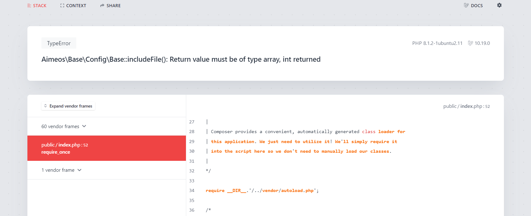

I am trying to install a custom extension for laravel aimeos on my local machine, and it is showing the following error when I try to access the shop url on local host.
Aimeos\Base\Config\Base::includeFile(): Return value must be of type array, int returned
This wasn't happening before I created the extension

- response
- Screenshot 2023-08-18 104510.png (80.04 KiB) Viewed 19673 times

Re: type error when installing custom aimeos laravel package
Check the ./config/ directory of your extension. There seems to be at least one .php file which doesn't contain:
I solved the issue. The config files were all in the correct format. But when I unzipped the istore-platform directory it included zoneIdentifier files which were causing the problem. The page worked again when I deleted these files.
