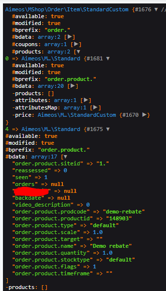

My rebate is getting added as a product when adding it in the basket.
It gets added to the "products" array of the order item.
$this->standardBasket->getProducts() retrieves both the rebate item and the products.
Payload:
b_prod[0][quantity]: 1
b_prod[0][position]: 0
b_coupon: test
What could be the problem?

That's intentional as many ERP and most fulfillment systems can't handle rebates as part of products.

I have a clean installation on local. I added a rebate to it the same way.
I printed it in the standard basket with dump( $this->standardBasket ).
When there is a rebate added to the order, the rebate is not added to the basket as a product in the local installation.
The local installation has aimeos laravel version ~2023.07.
