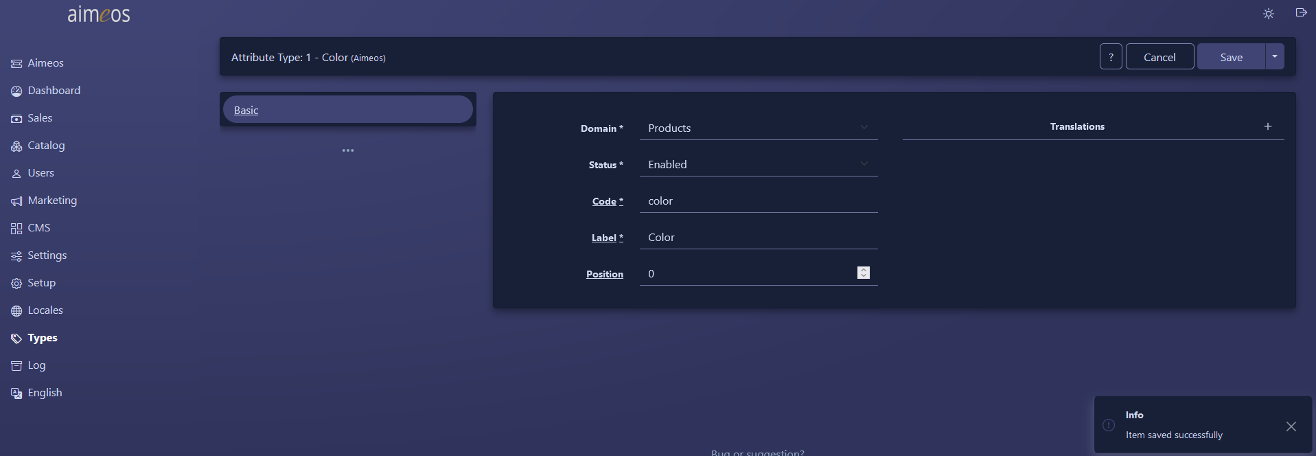

As in the title, attribute type translations do not get saved, when i press save it just dissapears and it doesn't work in frontend either. Tested both on main project and new installation. Also it doesn't throw any errors.

- Untitled4.png (59.27 KiB) Viewed 30027 times

Thanks for the hint! The problem has been fixed in aimeos/ai-admin-jqadm 2024.04 branch. To get the latest code until it's tagged for the new release, use:
composer req aimeos/ai-admin-jqadm:2024.04.x-devProfessional support and custom implementation are available at Aimeos.com

Thank you, it works.
