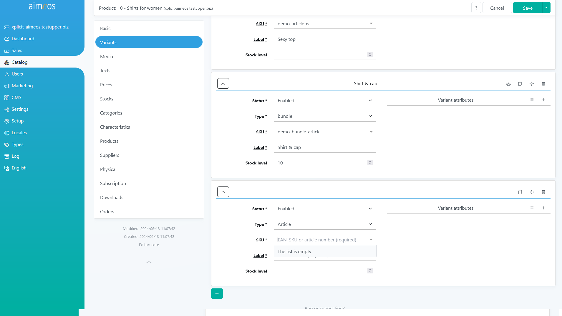

This is a fresh install and the demo group product that comes with it, in it I can change the product variant sku to another article
Same install, same demo product, I added a new entry to variants and I can't select an existing product
(I also tried creating a new group product and same thing, also tried creating my own product articles and can't select them either)
Edit: also when I write an existing product there it gives me the error that sku already exists
Edit2: seems like graphql returns an empty searchProducts list
Edit3: this does not happen your demo did my install go wrong or something?
Edit4: checked and also switched from 2024 to dev, same thing

We can confirm the problem and will find a solution for that

The problem has been fixed now and a new release of aimeos/ai-admin-jqadm is available.

Can confirm, thank you.
