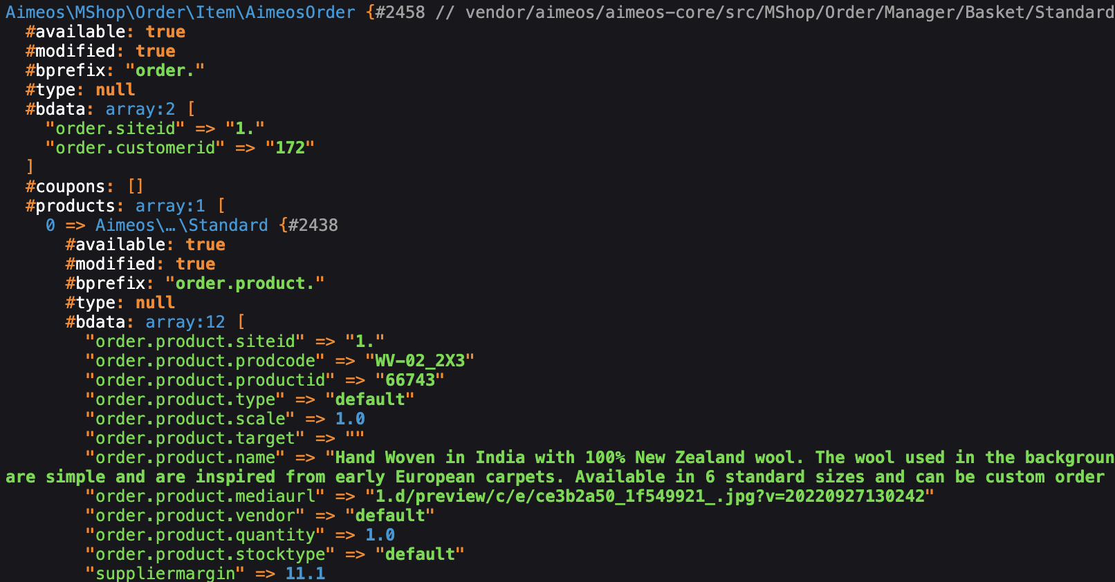

Sorry guys another error appeared with the serialization of the closure. Can you take a look, please ?
Exception {#2674 // vendor/aimeos/ai-client-jsonapi/src/Client/JsonApi/Base.php:205
  #message: "Serialization of 'Closure' is not allowed"
  #code: 0
  #file: "/var/www/html/vendor/aimeos/aimeos-core/src/MShop/Order/Manager/Basket/Standard.php"
  #line: 198
  trace: {
    /var/www/html/vendor/aimeos/aimeos-core/src/MShop/Order/Manager/Basket/Standard.php:198 {
      Aimeos\MShop\Order\Manager\Basket\Standard->saveItem(Iface $item, bool $fetch = true): Iface …
      ›         $serialized = base64_encode(serialize($clonedItem));
      › \t\t$idx = 1;
      arguments: {
        $value: Aimeos\MShop\Order\Item\AimeosOrder {#2947 …}

Posts: 8640
Re: Aimeos Context Serialization Issue
Post by aimeos » 12 Dec 2024, 14:14
Can you post your code so we can see what you are trying to serialize?

Post by sergey030 » 12 Dec 2024, 14:19
Yes, please.
$serialized = base64_encode( serialize( clone $item->getItem() ) );

Posts: 8640
Post by aimeos » 12 Dec 2024, 16:37
The getDepositOrder() is your problem. You can't serialize a basket which contains a using a manager. Instead, you have to extend the order manager and add the data when fetching the records from the database. Overwrite/extend the searchRefs() method for that: https://github.com/aimeos/aimeos-core/b ... d.php#L432
