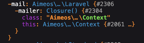

The problem turned out to be not in getDepositeOrder(), but in the event registration for plugins.
The problem is that in the listeners object there are closures here is an example of the object. How can I remove it from here ?
I have attached screenshots where there are closures in the listeners property.

- Снимок экрана 2025-01-08 в 13.50.28.png (38.58 KiB) Viewed 25417 times
- Снимок экрана 2025-01-08 в 13.49.01.png (90.61 KiB) Viewed 25417 times

Use this to remove all listeners:
$orderItem->off()Professional support and custom implementation are available at Aimeos.com
