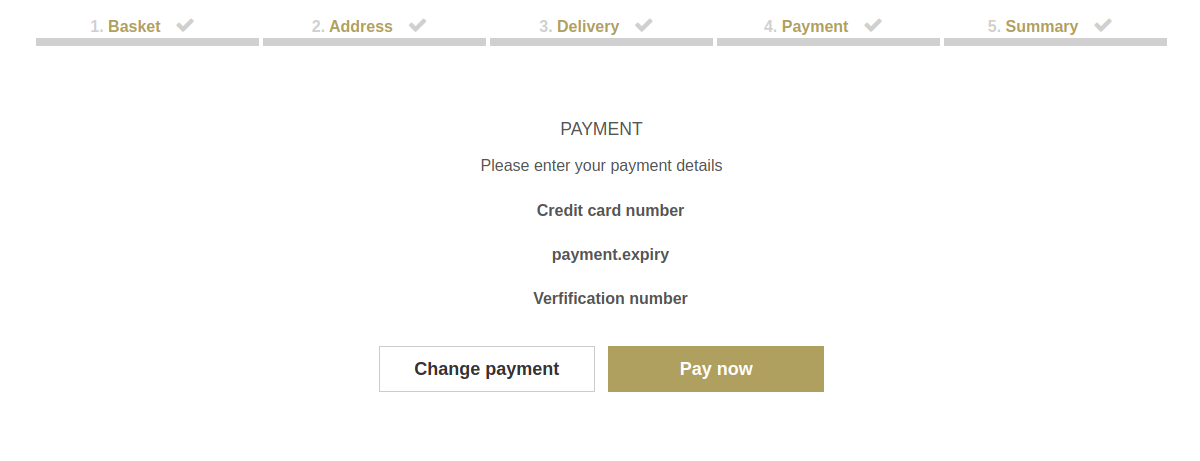

Hi guys, I also have problems with Stripe.
My version:
aimeos/ai-laravel                     2019.07.3  Laravel adapter for Aimeos web shops and e-commerce solutions
aimeos/ai-payments                    2019.07.3  Payment extension for Aimeos web shops and e-commerce solutions
aimeos/aimeos-core                    2019.07.11 Full-featured e-commerce components for high performance online shops
Seems I have configured it properly, but in checkout I don't get a form where I would have to set card number and other.
I am trying it on my local machine, and on remote server I had the same. I got error at once as on screenshot:
Screenshot from 2019-09-28 12-14-14.png (25.85 KiB) Viewed 7478 times

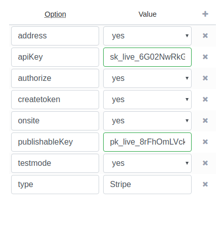

I took a look at /var/www/schmuck/ext/ai-payments/lib/custom/src/MShop/Service/Provider/Payment/Stripe.php and seems there are some fields which are missing in admin interface. Maybe this is why I don't get payment form when checkout ?
On the attachments is my stripe fields on the back-end
Screenshot from 2019-09-28 13-53-47.png (26.78 KiB) Viewed 7465 times

Seems I have figured out it. In console I got: (index):1 Uncaught IntegrationError: Live Stripe.js integrations must use HTTPS
But I have set testmode on my settings. Can I test it without https ?
