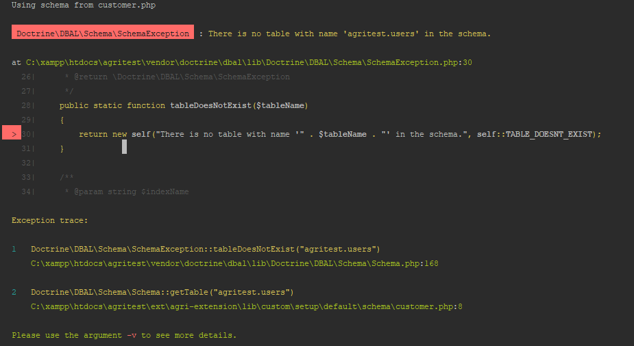

Post by yong » 17 Jul 2019, 10:49
I've this error
Re: setup task
Post by aimeos » 17 Jul 2019, 10:55
Make sure your extension depends on ai-laravel in the manifest.php file of your extension. Otherwise, the execution order is random.
