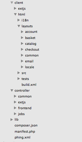

anilsharma
- Posts: 5
- Joined: 19 Jan 2016, 19:45
Re: Overwrite existing templates (Laravel)
please see attachment
- this is how extension is inside extension folder . ext/mnamr and then files can be seen in screenshot . let me know how it should be ? thanks
As I can see no files, it's difficult to say if everything is correct.
You should check this again:
- Do you use Laravel 5.1 LTS (5.2 made some problems up to last week)
- Do you use the Aimeos Laravel 1.x package for Laravel 5.1
- Did you create the right extension version (2015.x) at https://aimeos.org/developer/extensions/
- Only copy the "catalog/detail/body-default.html" template to the same location in your extension ("client/html/layouts/catalog/detail/body-default.html") and make a test change in the HTML code
- Clear your cache with "./artisan aimeos:cache"
- Check if the test change is visible in the catalog detail view
Laravel 5.2 works with Aimeos Laravel 2016.01 since last week.
