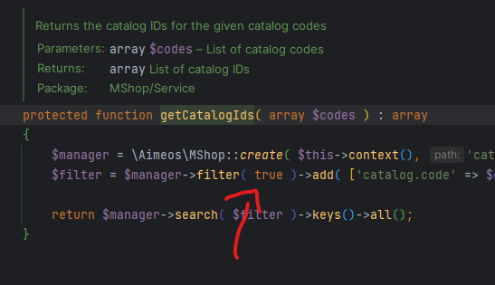

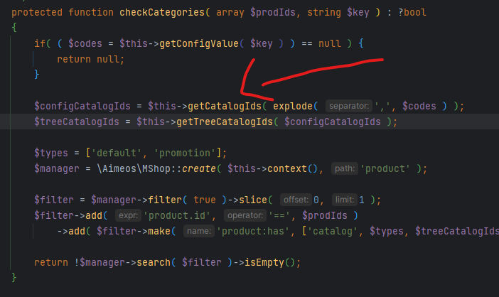

I checked in detail the error and made several tests. The issue occurs because the getCatalogIds function returns an empty array. I checked the configuration of the category and had it configured with the state: "hidden", apparently this function does not take into account the categories that have this state.
To avoid generating an error in the frontend, it might be a good idea to verify that the $treeCatalogIds variable that contains the array is not empty to avoid generating a MariaDB/MySQL error.

The used "->filter(true)" statement adds "status > 0" to the filter and hidden has a value of "2" so that should not be the problem. Can you check if the configured category codes are different from the used ones in the mshop_catalog table?peter69 wrote: 31 Jan 2023, 04:40 I checked in detail the error and made several tests. The issue occurs because the getCatalogIds function returns an empty array. I checked the configuration of the category and had it configured with the state: "hidden", apparently this function does not take into account the categories that have this state.

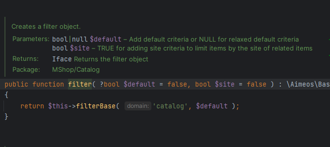

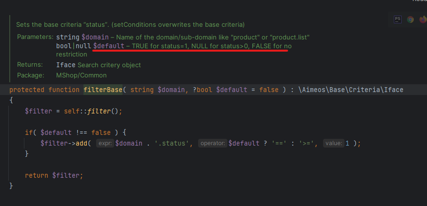

I have checked the table and they have the correct code configured. I checked the filter and filterBase function and I see that when you pass true, it will only take into account the state: 1.aimeos wrote: 01 Feb 2023, 09:21The used "->filter(true)" statement adds "status > 0" to the filter and hidden has a value of "2" so that should not be the problem. Can you check if the configured category codes are different from the used ones in the mshop_catalog table?peter69 wrote: 31 Jan 2023, 04:40 I checked in detail the error and made several tests. The issue occurs because the getCatalogIds function returns an empty array. I checked the configuration of the category and had it configured with the state: "hidden", apparently this function does not take into account the categories that have this state.
You can see it in the screenshots.
- screenshot---.png (41.2 KiB) Viewed 6754 times
- screenshot--.png (35.46 KiB) Viewed 6754 times
- screenshot-.png (54.3 KiB) Viewed 6754 times

OK, this means we need to change:peter69 wrote: 03 Feb 2023, 03:32 I have checked the table and they have the correct code configured. I checked the filter and filterBase function and I see that when you pass true, it will only take into account the state: 1.
filter( true) -> filter( null )Code: Select all
composer req aimeos/aimeos-core:2022.10.x-devProfessional support and custom implementation are available at Aimeos.com
