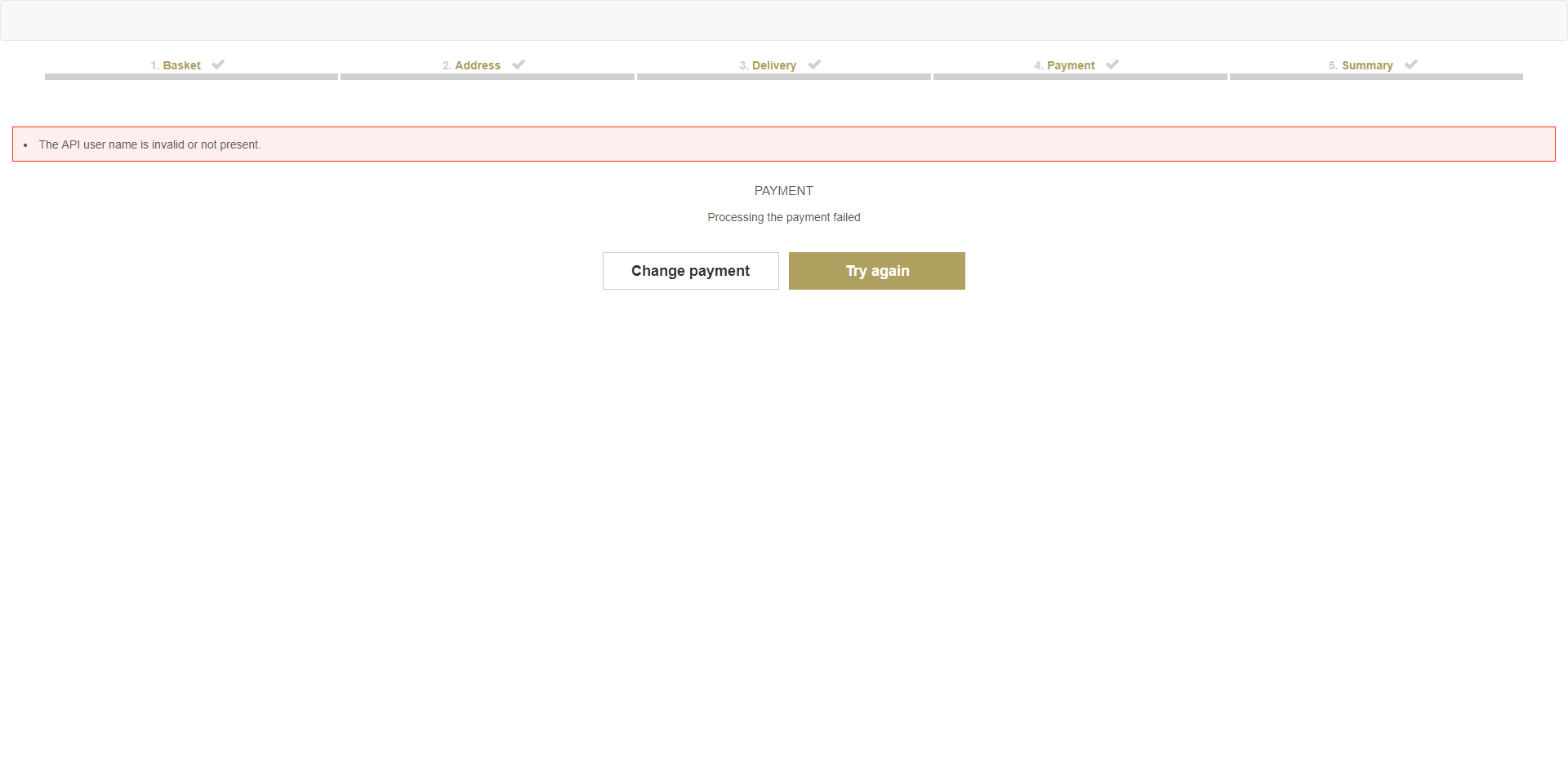

Hello Aimeos,
I have two questions -
Frontend
1.I have implemented Authorize.net CIM class successfully. When i submit form it gives me one error
The api username is invalid or not present what to do ?

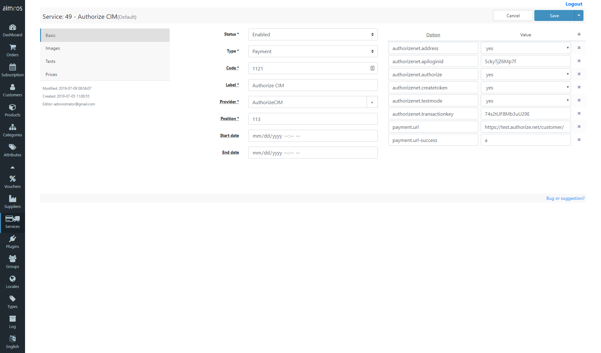

Backend
1. Is this the correct way to set up authorize.net cim service in admin panel ?
Thankyou
Re: Regarding Authorize.net issue
Post by aimeos » 11 Jul 2019, 09:00
Seems like you don't pass the required values correctly to Authorize.net
