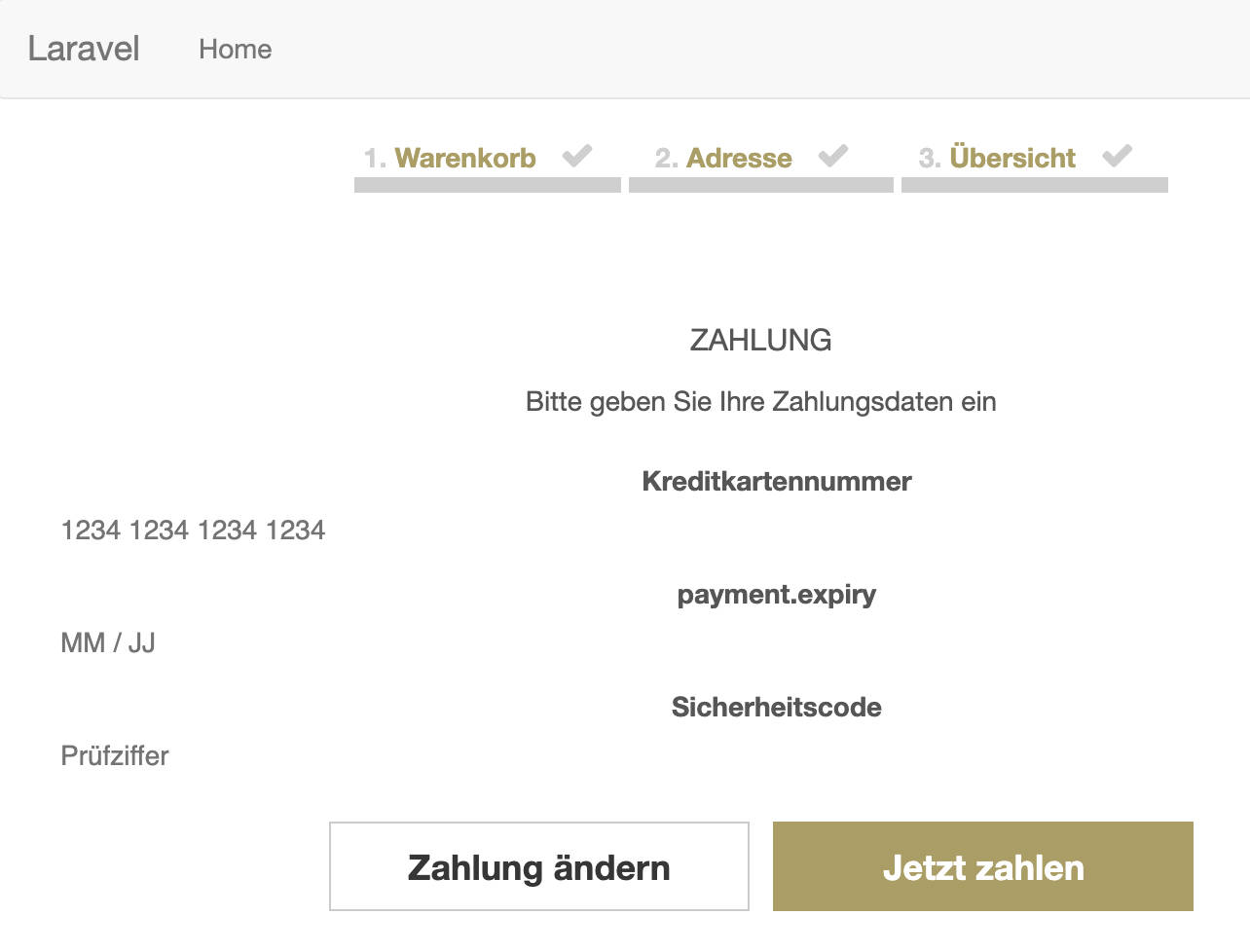

I'm a bit confused. It would indeed help to see this implemented in any provider, that's why I also tried out other payment methods. But I have Stripe installed and the payment page is only added as an additional step in the checkout process, there is no popup:
Re: Popup / lightbox payments
Post by aimeos » 10 Nov 2019, 11:59
It looks the same bit is totally different in the backend because the form is created via Javascript and also the communication between the client and the Stripe server is AJAX only compared to a redirect to the payment gateway server in traditional mode.
