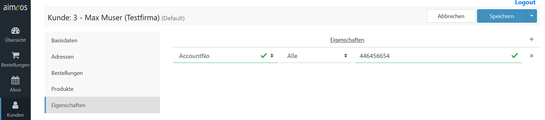

I added a custom property (for AccountNo) to my customers object.
How can I retriev and show the property value (account ID) in the customer profile view (/shop/profil)?
I havent found any examples. I tried but without success
thanks
$this->getRefItems( 'customer', null, 'accountid' ) as $attrId => $attrItem ) : ?>thanks
- customer property.PNG (30.76 KiB) Viewed 5851 times
