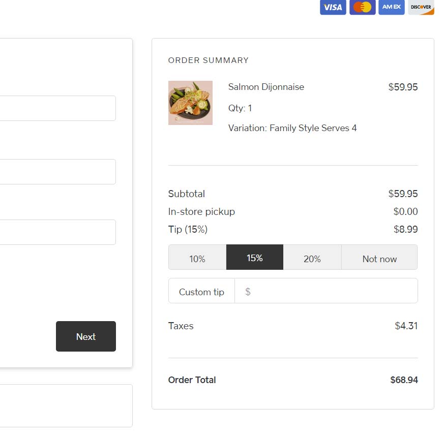

Re: Option to Add a variable Tip
Thanks - I'm at a loss as to how to pass the array of tip values to the decorator and how to get the html to show up in the cart.
Attached is what I have so far but I'm especially struggling with how to modify a copy of the second decorator example (Supplier.php).
From copy of the costs.php decorator:
From copy of supplier.php
And here's an example of what we want to achieve (From woocommerce)

}And here's an example of what we want to achieve (From woocommerce)
- example.-tips.jpg (35.94 KiB) Viewed 5896 times
