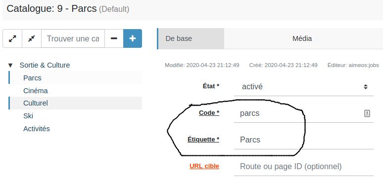

Here is the screenshot of the categories(to show there are already there)

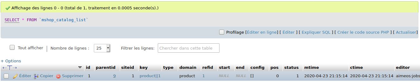

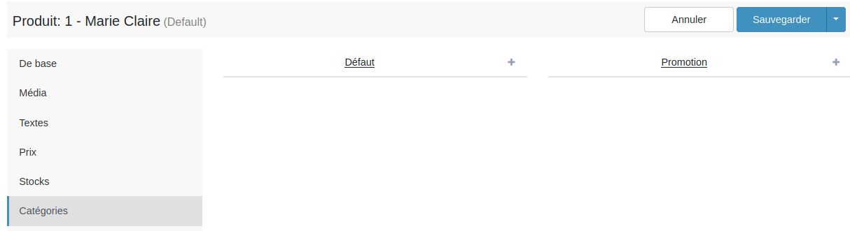

Import is running fine but when I'm checking the product catalogs, nothing appear.
When I set a catalog/category manually everything is fine but with the product/import/csv nothing appear.
What am I doing wrong ?
PS : I checked in DB and product seem linked too ... I'm kinda lost :)
