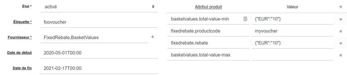

My problem is quite simple. I fail to add any coupon code to the basket.
Here is what I'm doing

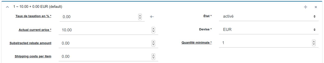

1 - creating voucher product
2 - setting a price (not sure it's useful)
3 - then I create gift card
following in next reply

4 - to which I attach codes
5 - finally using it without success
what am I doing wrong ???
Thanks for your help

tyteck wrote: 28 May 2020, 11:11 4 - to which I attach codes
You've entered the coupon code and amount in the filter bar of the code table instead of creating a new one. Click on the "+" symbol at the right corner of the table header to add a new code.
Also, use "Default" as type for the discount product. "Voucher" is only for vouchers that are sold to customers.
