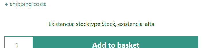

I cant find the problem, i have different products that whenever added to the basket display errors like "Product is out of stock", "Remove item from basket", but these products do have stock. Actually at the details page it shows the stock level as high.
I have no idea what is happending. Could you please help me?

Another thing, the stock level at details page displays wierd, where do i set these attributes and how do i fix that.
Thank you very much!

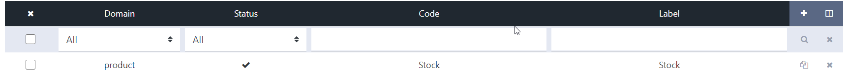

Did you assign a different stock type than "default" in the admin interface for that product?

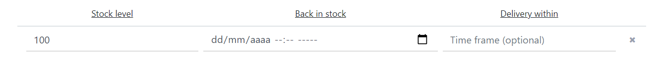

This is the stock configuration for one of these products

This is the stock type config. I´ve changed the code and label to "Stock" just to try to find out what is happenning with translations.

Did you reuse the SKUs of old products for new ones? In that case, the stock entries in the mshop_stock table may not have been removed too.

Another source of the problem: You created a selection product, added a stock level to that selection product but not for its variants. Then, you get that behavior.
