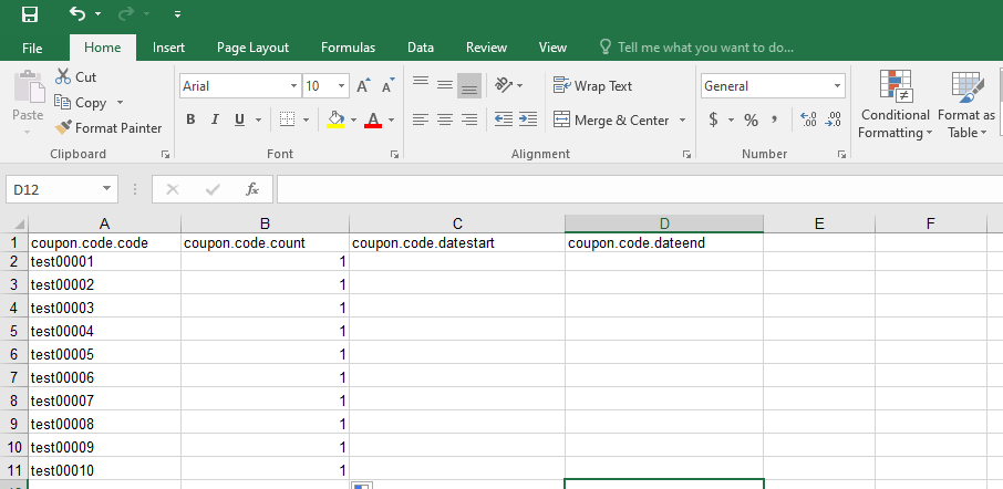

Hello again,
I tried to make excel file (please see attachment below).
excel file
excel file
However, if I import this file, nothing happens.
Could you look it up please?
Thank you
Re: How to Import Coupon Codes ?
Post by aimeos » 31 Jul 2020, 09:48
Make sure you run the "coupon/import/csv/code" job regularly via a cron job.
