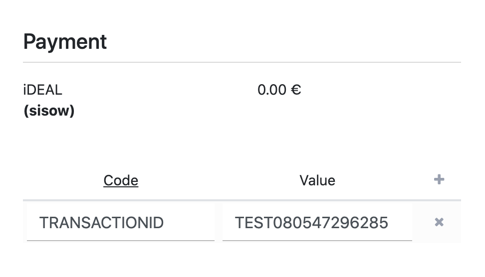

I'm adding the capture() ability to an OmniPay payment method, but I run into the following problem.
I place a new order and the payment is successfully authorized through the omnipay service.
The order has the '\Aimeos\MShop\Order\Item\Base::PAY_AUTHORIZED' status and the table "mshop_order_base_service_attr" has a record with the correct TRANSACTIONID.
Before save
Before save
To get the cron to process the capture() I will change the delivery status.

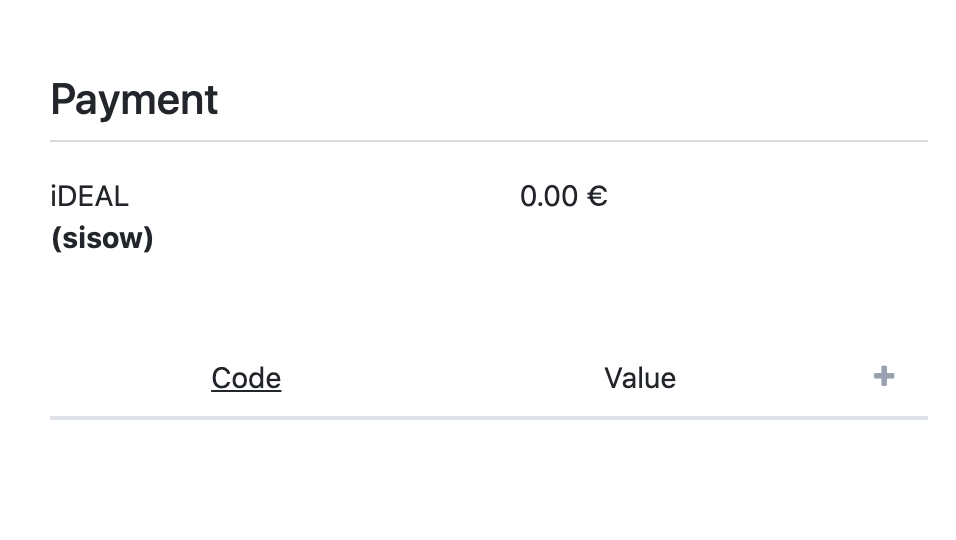

I do this in the admin by going to the 'Invoices' tab on the oder page. I click on the pen to unlock the status dropdowns and I change "delivery" to "\Aimeos\MShop\Order\Item\Base::STAT_DISPATCHED".
Then I click "Save".
When the page reloads, the payment info is gone:
After save
After save
The 'order/service/payment' cron now picks up the order, but because the \Aimeos\MShop\Service\Provider\Payment\OmniPay::getTransactionReference() method can't find the DB record, it fails.
Even when I click save in the admin on an order without changing anything, the transaction information is also lost.

Post by aimeos » 01 Sep 2020, 17:59
Thank you for your bug report! We can confirm the problem in 2019.10 and 2020.07.
The problem must be somewhere here:
https://github.com/aimeos/ai-admin-jqad ... #L550-L581

Sorry for the late reply and thank you for pointing me in the right direction.
I've created a pull request for the 2019.10 branch that fixes the problem for me.
https://github.com/aimeos/ai-admin-jqadm/pull/138
