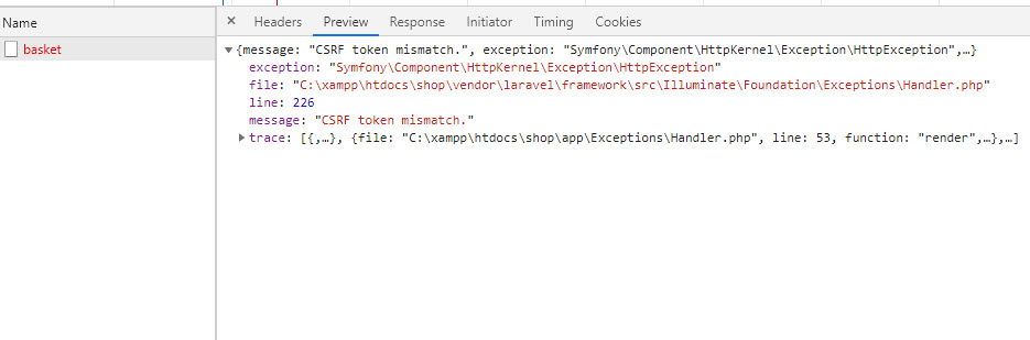

also when i change session.same_site=None and session.secure=true and then try to add product to basket get this exception error:
exception: "Symfony\Component\HttpKernel\Exception\HttpException"
file: "C:\xampp\htdocs\shop\vendor\laravel\framework\src\Illuminate\Foundation\Exceptions\Handler.php"
line: 226
message: "CSRF token mismatch."

i explain that when i set same_site = None in session config of laravel this problem was solve but the add to basket and other actions in the shop failed because of csrf token mismatch error,
@aimeos please give me a solution to solve this problem.

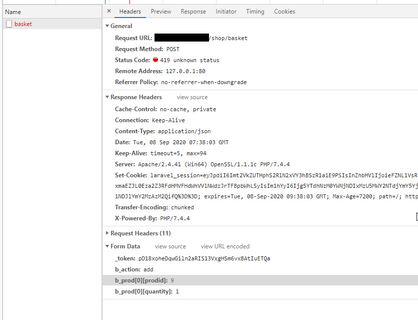

i think you don't understand my mean, please pay attention to this:
i change 'same_site' => 'none' in config/session.php file and secure = true, after this change the problem (session of 'aimeos/orderid' and basket session clear after customer redirect back from payment gateway to shop) was solved but in the other functions of shop application i get errors for "CSRF token mismatch." (for example please see error in attached images that is for when i click on add to basket botton)

Maybe you should ask your question in a Laravel forum.
The cookie is available and the token is sent according to your screenshots.
