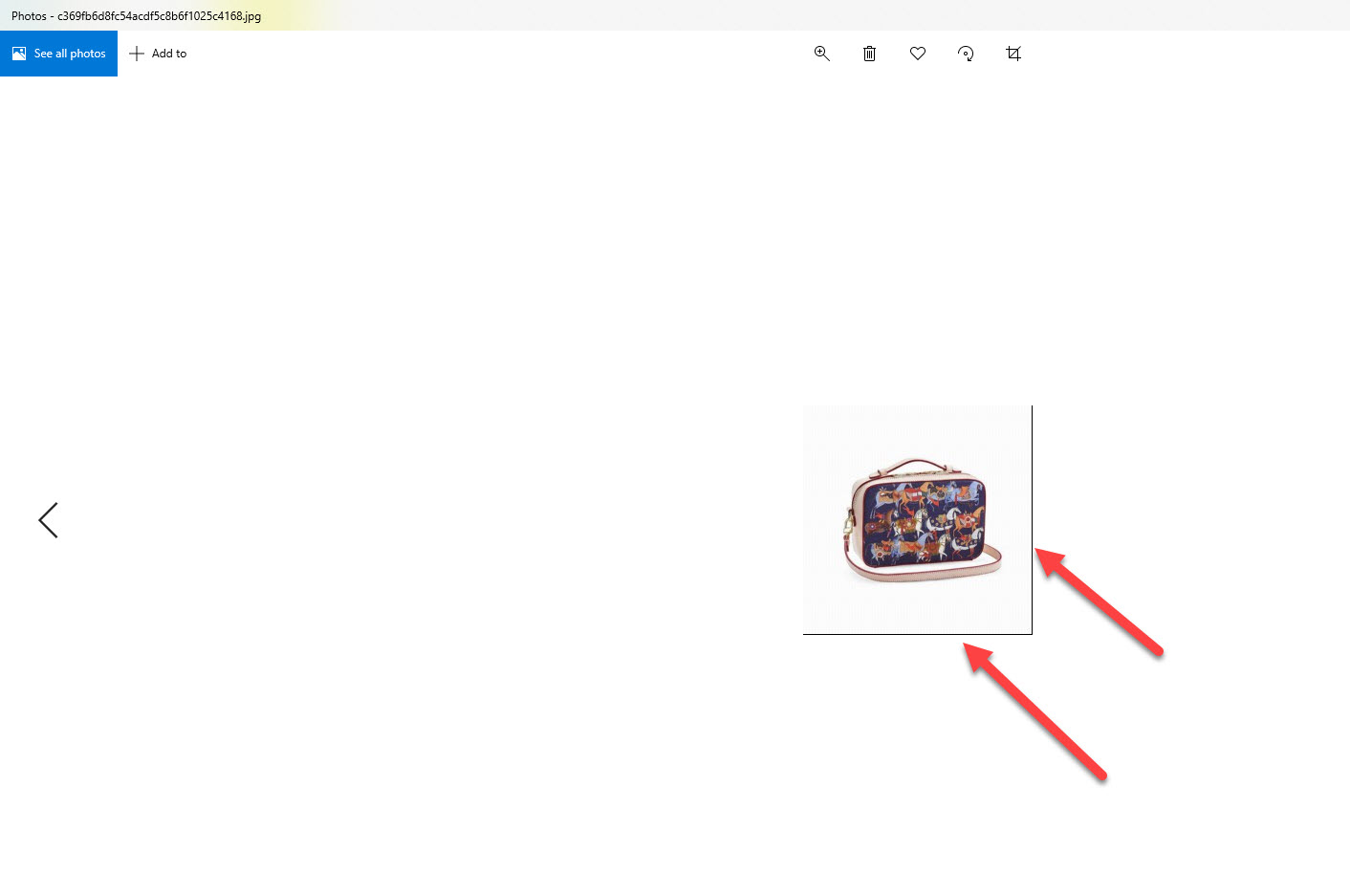

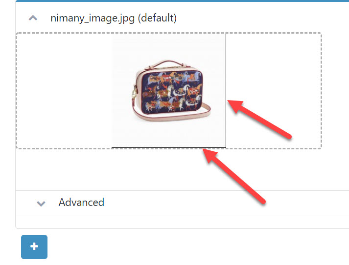

create black lines on the bottom right of the photo after uploading
i use aimeos/laravel 2020.04
when i uploud image for product and deliery or payment provider, image was change and save with black lines in right and bottom of that image after uploud (according to the attached image).
i check uploaded image in preview folder and find out black lines affected on uploaded image;
Furthermore white background of images was change with light grayscale;
What is the reason for this?
What can I do to prevent this from happening?

Re: create black lines on the bottom right of the photo after uploading
This is a problem of the GD library on transparent images. If you use Imagick instaead, there will be no shadow lines:
https://aimeos.org/docs/Configuration/C ... rd/options
