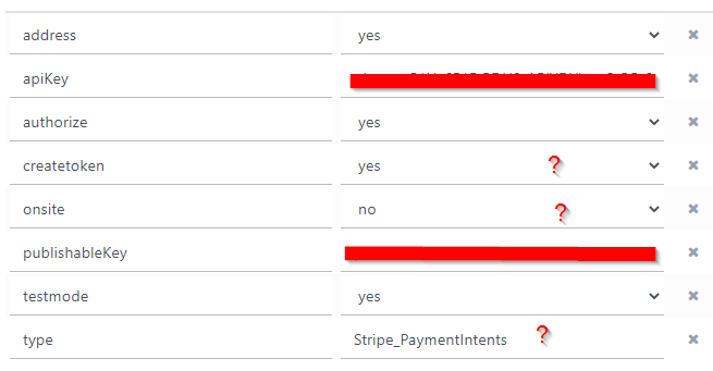

1. Where is the front-end form for stripe payments generated?
2. I also wonder what the extra fields on the backend configuration is ment for. [/list]
Your documentation https://aimeos.org/docs/2020.x/manual/services/#stripe only mentions the two keys, authorization, address and testmode. What do the others do (see picture)?

- stripe que.png (12.17 KiB) Viewed 4740 times

createToken: Enable token based payments for recurring subscriptions
onSite: Not used because it's hard-coded in the Stripe provider
type: The Omnipay driver type (there are several for Stripe)
You can get a description for most fields if you click on the "Option" column header or at the "?" button left of "Cancel"
