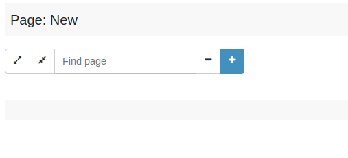

Hi community!
I need to integrate something like pages manager, with nested levels to show them on frontend menu. For this purpose I think catalog entity suits pretty well. I have copied all files from catalog (manager, standard, item, templates). And of course have renamed catalog to page everywhere. So I got the page item in back-end menu. No errors. I have attached the image with result. But items not loading. I think I have to configure jsonadm or something like this. Because I see, there are some ajax calls and no needed data come from server.
I will be very thankful for some clarifications or tips!

Re: Setup new entity for jsonadm
You need to implement a JSON REST endpoint for your page manager like the catalog endpoint in the jsonadm extension:
https://github.com/aimeos/ai-admin-json ... in/JsonAdm
