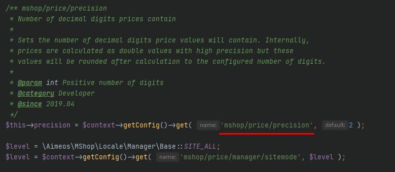

A small note.
My version of aimeos-core/lib/mshoplib/src/MShop/Price/Manager/Standard.php has a little bit different config string:
$this->precision = $context->getConfig()->get( 'mshop/price/precision', 2 ); (not 'mshop/price/manager/precision'): see attach.
So when I update the core I will loose this config. Probably it would be good either do not change config strings in future versions or make some kind of compatibility.
A small note.
