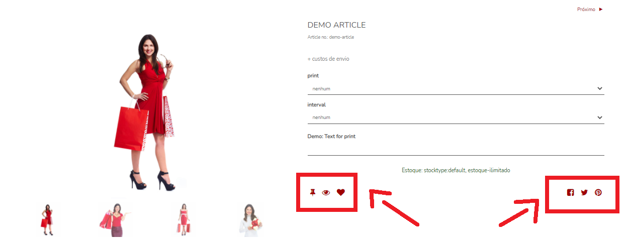

Hi, I need some help in delete some things in my project aimeos, I need to delete some div and nav but I really dont know how to do it, I readed the topic remove components but it doesnt helped me.
Thanks, Arthur.

Hi
I need pull out elements like these:
Sem título.png (98.43 KiB) Viewed 5610 times
Re: Remove specific div and nav at aimeos project
Post by aimeos » 20 Apr 2021, 10:45
Overwrite the catalog/detail/body-standard template in your own extension and remove these lines:
https://github.com/aimeos/ai-client-htm ... #L287-L320
Post by ArthurHenrique » 20 Apr 2021, 11:39
Thank you for the answer, but I already do this and nothing happen, I remove exactly these lines and doesnt work, I was thinking about a cache problem, so I do the comand php artisan cache:clear and again nothing happen. Are there another solution for this problem? Thanks again
Post by aimeos » 20 Apr 2021, 11:43
To clear the Aimeos content cache, use:
php artisan aimeos:clear
During development, you should deactivate the cache:
https://github.com/aimeos/aimeos-laravel#hints
