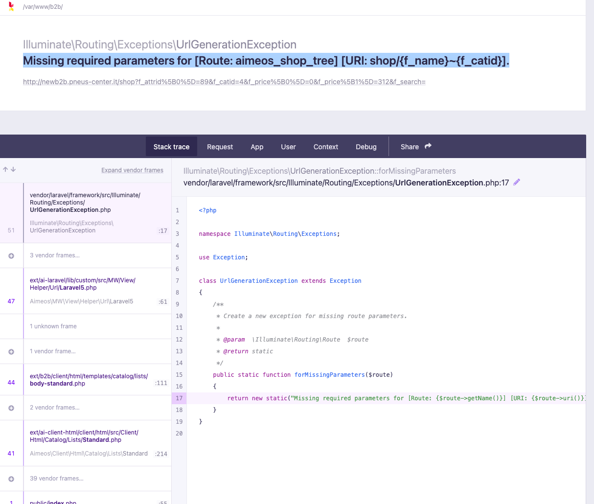

I have enabled
'filter' => [
'tree' => [
'force-search' => 1,
parameter to permit to filter products in the current category.
But when i try to choose an attribute value, i receive the error:
Missing required parameters for [Route: aimeos_shop_tree] [URI: shop/{f_name}~{f_catid}].
In attach the screenshot
thanks
Alessandro

We can't reproduce the problem. What steps did you perform to trigger the error?
Re: Missing required parameters for [Route: aimeos_shop_tree] [URI: shop/{f_name}~{f_catid}].
I simply select a category and then try to filter product with an attribute
We fixed it by adding the f_name parameter to the template too:
https://github.com/aimeos/ai-client-htm ... ce3604cb20
You can either add it to your own template or you can install it using:
composer req aimeos/ai-client-html:2020.10.x-devProfessional support and custom implementation are available at Aimeos.com
