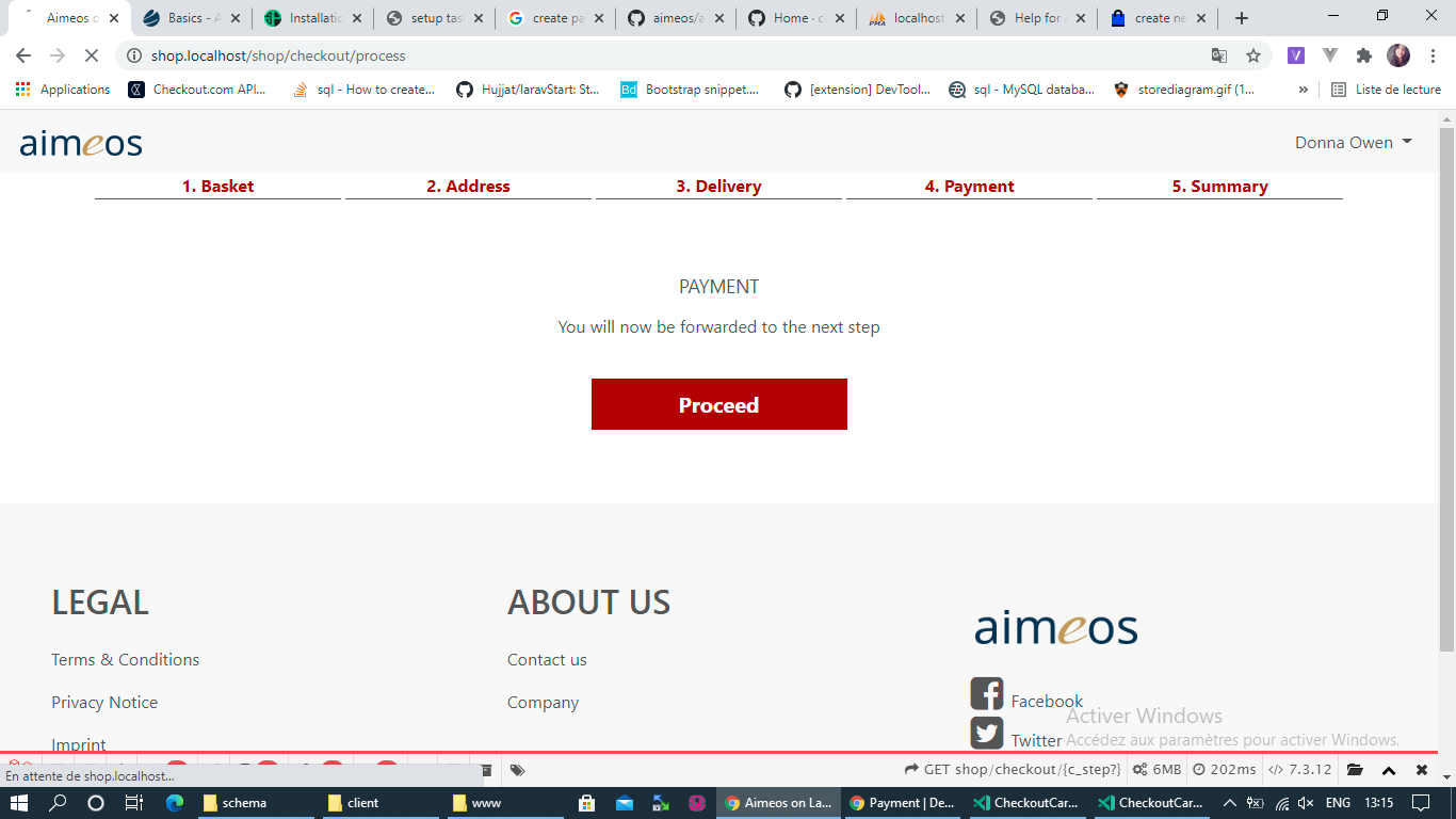

Hi i'm trying to create a new payment provider for checkout.com payment gateway for that I need to embed the Frames payment form in my payment page to enter card number, cvv...
So i need just one field that will be contain the card token and it will be required and hidden.
I have followed the procedure described here (https://aimeos.org/docs/2020.x/provider ... yment-form)
And after clicking in Buy now button it redirect me to (shop/checkout/process) page and this page keeps refreshing itself.

Hey,
I had a very similar issue, in order to resolve you have to ensure you pass an empty string for the url parameter in your providers form helper. I believe when you have no inputs that require the user to complete, it attempts to build the form and submit it to the merchant on your behalf
https://github.com/aimeos/ai-client-htm ... 1907-L1918
eg.
eg.
function getPaymentForm($order, $params) {
return new \Aimeos\MShop\Common\Helper\Form\Standard($url = '', 'POST', $list, false);

Hey
thanks a lot you solved my problem !
