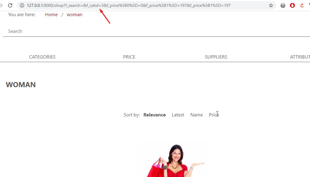

It seems there is a bug here.

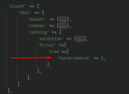

Enabling this config option (client/html/catalog/filter/tree/force-search = 1)

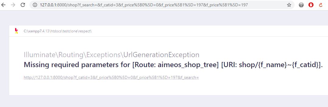

adds a new parameter f_catid to URL, but also causes error
Missing required parameters for [Route: aimeos_shop_tree] [URI: shop/{f_name}~{f_catid}]

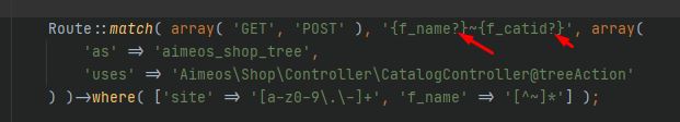

This error can be easy resolving by setting the route params to obligatory using "?"
But I'm not sure if this is correct behavior when a new config option is applied.
