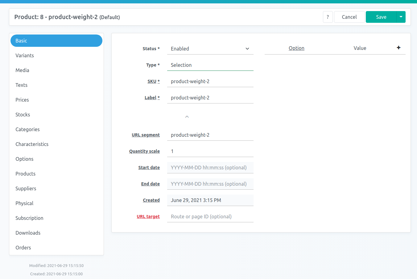

I try to achieve my goal to create product where is possible to select different weight with different price..
I have created product with type selection.
Also I have added 1 variant to variants..
This is a part from my config:
But on front-end I don't see any possibility to choose product variants...
I look at the code and on front-end this product consists child product, but it is not shown because no price set, I think so..
so question is how to set price for variant and how to connect price with specific weight ?
Please explain this moment, maybe you could provide some screenshots..
Thanks a lot !

],I look at the code and on front-end this product consists child product, but it is not shown because no price set, I think so..
Thanks a lot !
- Screenshot from 2021-09-15 12-39-18.png (109.21 KiB) Viewed 5827 times
- Screenshot from 2021-09-15 12-39-07.png (91.23 KiB) Viewed 5827 times
Re: Price depending on weight ?
In your example "variant-1" is your variant article for the selection product. Go to the product list and click on "variant-1" product in list view. There you can add the price and the weight for "variant-1".
