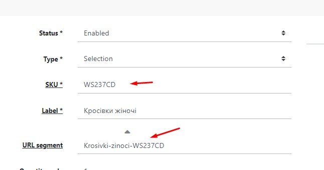

I case I have 2 or more products with the same product name then I have the same product URL segments by default - and this is a problem, since all these products have totally the same URLs. Could you please advice what is the best way to change the default method of URL segment creation? Say I'd like to have the product's name + product's code as its URL segment. For instance,
/product_name_product_code - see the snapshot

And when I set my custom URL using setUrl() function (for instance $item->setUrl($item->getURL() . '-' .$item->getCode()))
then on the catalog detail page there is error "No value for key "detailProductItem" found"
To fix this error I need just to save the product details page (/admin/default/jqadm/get/product/23168?lang=en) via standard Save button - and then everything's ok.
It seems the setUrl method doesn't update the mshop_index_text with new URLs.
So the question is the same: what is the correct way to update the product URL.segment value inside the code?
