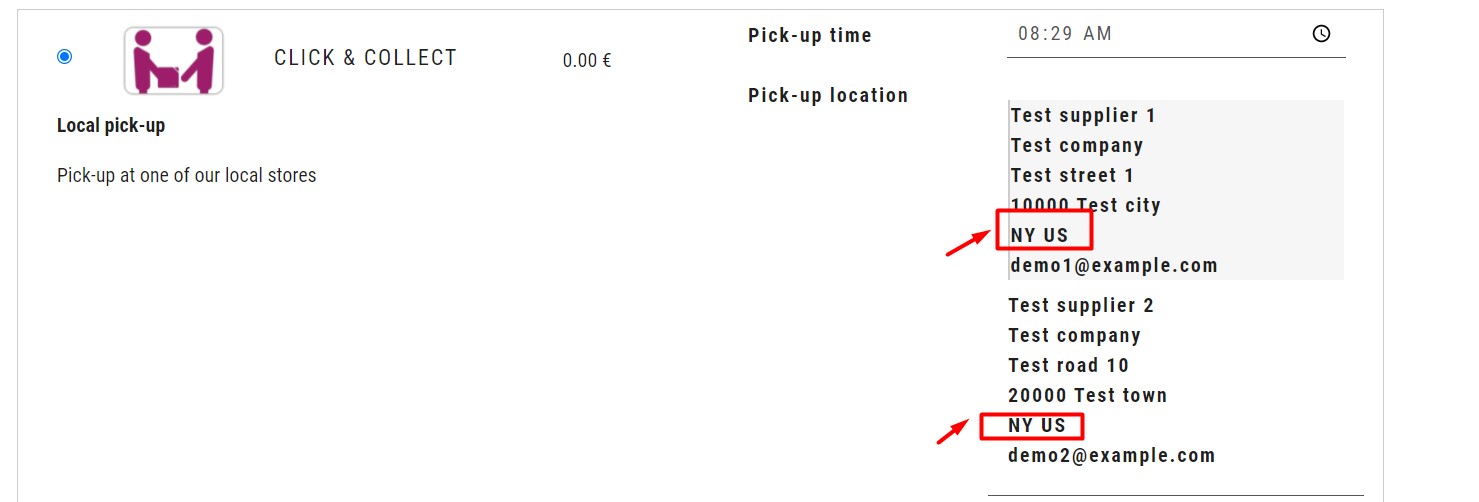

This is how the countries added for the click&collect option appear on the frontend with their ISO codes. How can I add the name of the country instead of the ISO code? Translate doesn't work

We need to add:
$context->translate( 'country' , $addr->getCountryId() ),
here:
https://github.com/aimeos/aimeos-core/b ... er.php#L91
and here:
https://github.com/aimeos/aimeos-core/b ... r.php#L112
Can you create a pull request so we can merge the necessary changes into the core?
