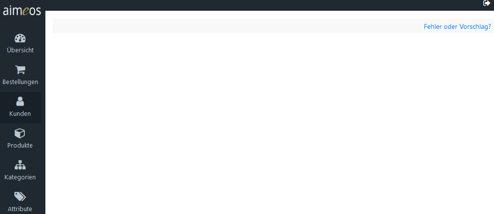

in aimeos 2020.10.9:
  1. go to customer section in aimeos' admin area (jqadm)
    -> as expected, all customers are listed in a paginated table
  2. now go to last page or increase page-limit so that all customer are displayed on a single page
    -> failure: customer table not displayed at all:
    blank page.png (12.59 KiB) Viewed 2134 times

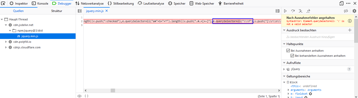

There are no entries in aimeos log but browser debugger shows:
SyntaxError: Element.querySelectorAll: '\' is not a valid selector
I have no clue why the table is no longer displayed
This behavior is only for the customer table. Product tables etc. work without any problems
Thank you!

Post by aimeos » 19 Nov 2021, 09:55
Seems like one of your customer entries has some data that isn't properly escaped and thus, rendering the data in the browser may fail. You should try to find out which record and what data makes problems.
