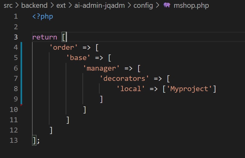

I am using laravel 6.x, PHP 7.4, Docker desktop/Ubuntu and the Aimeos 2021
Can I ask for a sample or a documentation link how to use a decorator for submanagers.
I would like to get/set records from mshop_order_base table.
I have these codes but I wasn't able to make it work.
Thank you

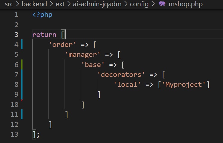

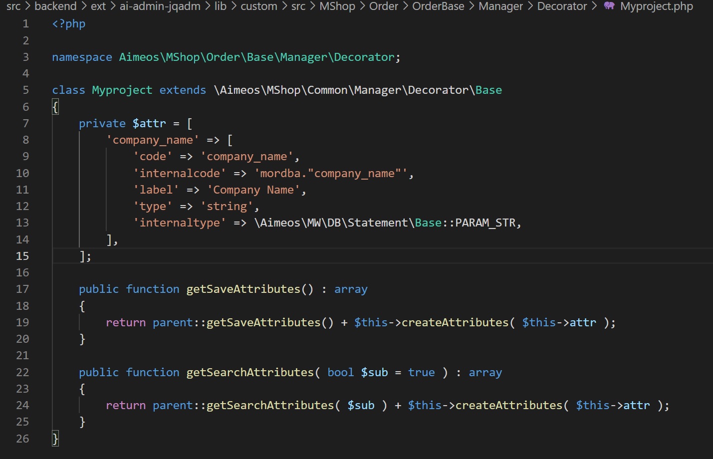

Post by IvanIgniter » 06 Jan 2022, 06:10
I have figure it out by making the structure like these.
