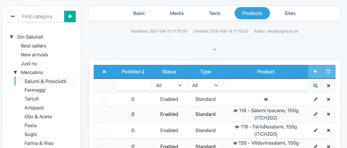

Hi.
In admin, I want to set a default order of products in a category. Basically control which products should be on top for the customer by default.
If I understand it correctly, this should be done by going into Catalog->Categories, select a category, go to the tab "Products"
Then you should be able to set display order by changing the numbers in the Position column, correct?
When I do this, i encounter some oddities.
First, if I change the position value (all is 0 by default) to 1 or -1 the reference to the product disappears from the listing leaving me with just an "eye-icon" instead of product data. The link from the icon also lacks the product id. Using the edit pen, I can see a list of products, but I can't assign it. It says "data saved successfully" but no product data is set.
Looking at the catalog -> products the edited product is still there without changes.
Am I doing something wrong, or is there something else going on here?
Screenshot 2022-02-15 at 12.06.05.png (179.77 KiB) Viewed 9287 times

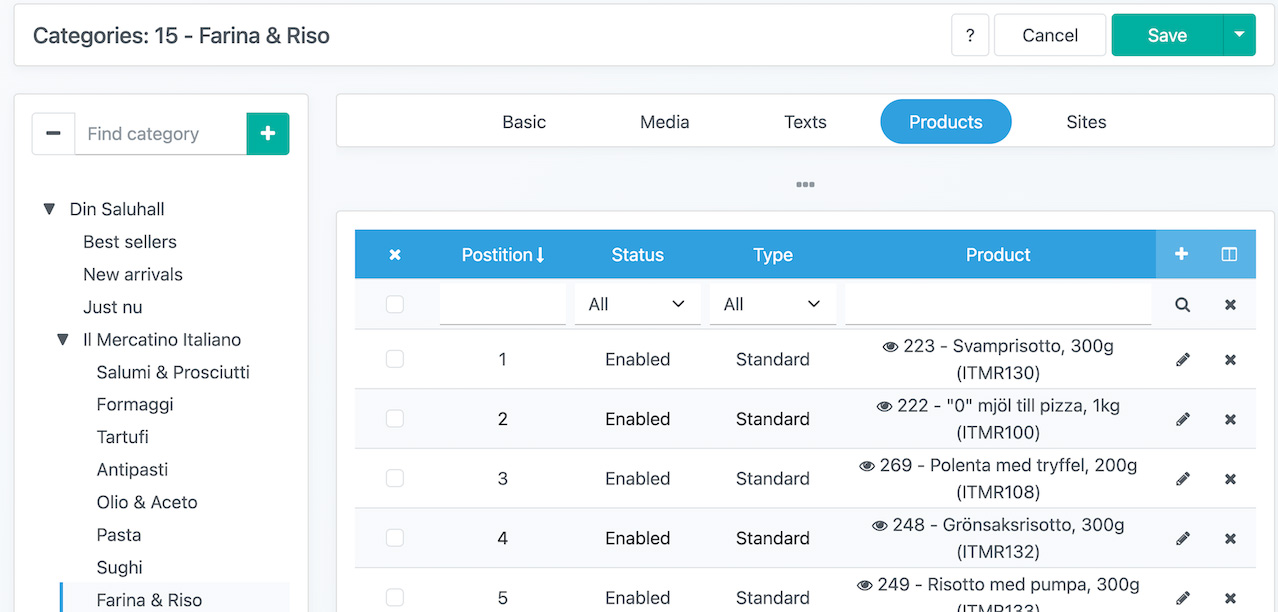

Back at this.
Images shows how I've ordered things in admin, and the result I got.
Note that the product " "0" mjöl till pizza, 1kg" is originally first in the list, and I've positioned it as #2 in admin, still it shows as #1 in the frontend.
Note that I'm using marketplace if that will make a difference, I can only add the product order in the category if I'm in the site that owns the products. I can't set the order from the top level site.
Looking in the mshop_catalog_index i see that the sort order is set for site 1.2 and for 1. it is 0 on all products in the category.
Switching to the other site in the url still gives the same order without position applied.
Intended sort:
Intended sort order
Intended sort order
sort admin.jpg (138.5 KiB) Viewed 9090 times
