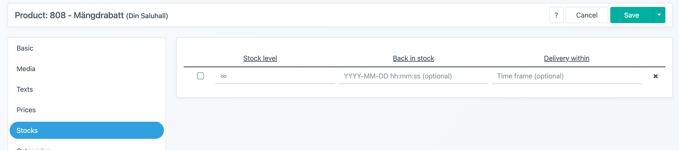

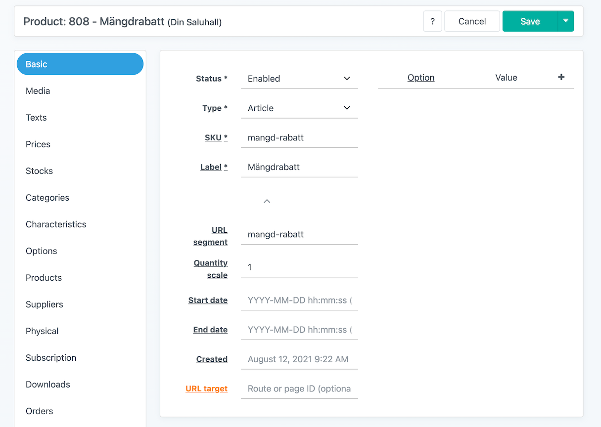

As can be seen in the attached screens, the rebate product I created has unlimited stock.aimeos wrote: 26 Feb 2022, 07:50 The item in $product you fetch from the database needs to have a stock item associated (can be unlimited too).
I don't know why I'm not seeing anything stockrelated though when I do $product->toArray()
This is how I retrieve the product, create a new one for the basket, give it values:
