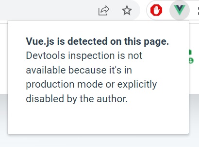

I am using laravel 6.x, PHP 7.4, Docker desktop/Ubuntu and the Aimeos 2021 (aimeos-laravel: 2021.10.4 / aimeos-core: 2021.10.13)
I would like to use vue devtool but this is what happened.
I have tried to google how to enable but no good. I did not able to find the import part of using vue.
Kindly help what to do to enable devtool?
vue disabled.jpg (32.47 KiB) Viewed 2293 times

You need to change "vue.min.js" to "vue.js" here:
https://github.com/aimeos/aimeos-larave ... de.php#L40
