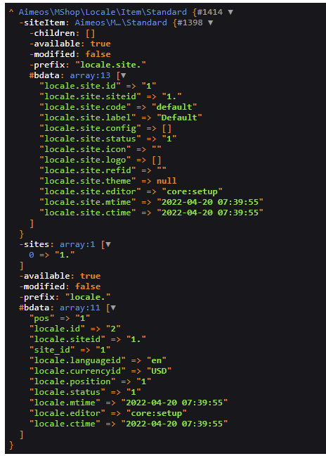

Ok, this return the locale item, but not site products.
How to add site products to the query?
$manager->bootstrap('default', 'en', 'usd', true, 1);- Attachments

This will return the products from the current site ("default"):
$manager = \Aimeos\MShop::create( app( 'aimeos.context' )->get(), 'index' );
$productItems = $manager->search( $manager->filter() );

Re: how to get list of products of a store
thank you very very much, clarified.
