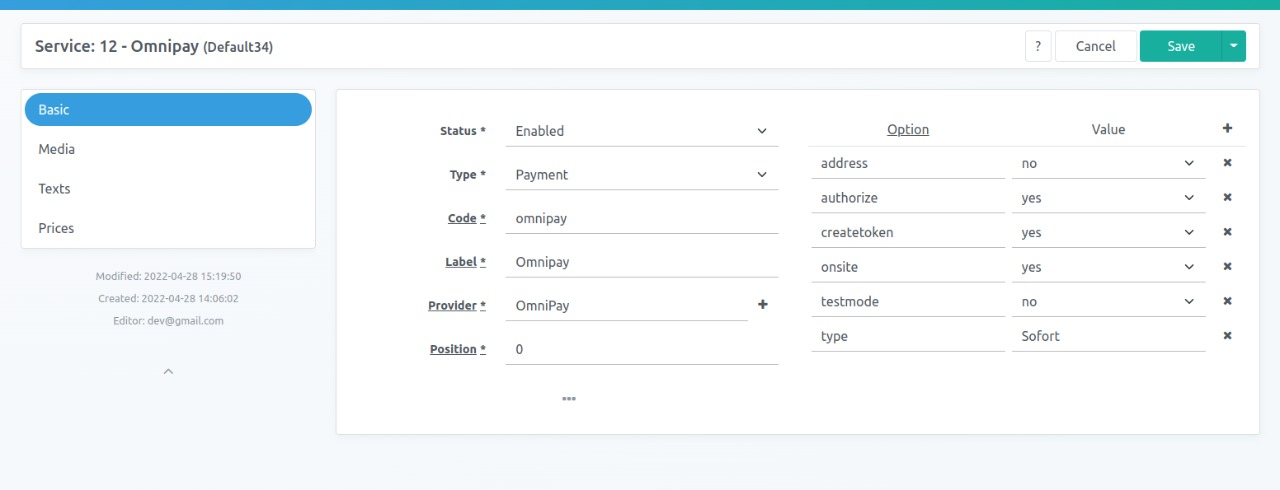

But problem with configuration. As described here https://aimeos.org/docs/latest/manual/services/#sofort there must be more fields in config, especially projectId, username, password.. etc..
But here is attached image of my fields..
What could be the problem? Thanks a lot !
- ca583340-a404-4407-a837-94a54ea3be6b.jpeg (50.65 KiB) Viewed 5536 times
Re: Omnipay-sofort installation/setup problems on ~2021.10
Use the "+" icon in the upper right of the Option/Value table to add more lines which you can fill the required configuration in.
