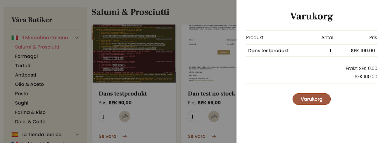

As the subject says, I've setup a price rule with -10% on a specific category.
I've added catalog to domains per the instructions here:
https://aimeos.org/docs/2021.x/manual/rule-decorators/
And the price is adjusted in lists and product detail page, exactly as advertized, but the price in the basket is the unchanged, standard price.

- Screenshot 2022-05-24 at 15.42.14.png (223.63 KiB) Viewed 8490 times

The referenced documentation is only for displaying the correct price but the source of the problem was in the basket/standard code which had missed the "catalog" domain when fetching products.
Can you please update and try again:
composer req aimeos/ai-client-html:2021.10.x-devProfessional support and custom implementation are available at Aimeos.com

I would just like to add to this issue in case someone runs on similar case.
When price rules were applied, from some reason changes were not applied to the basket.
Disabling ProductPrice plugin helped so pricing was applied correctly to the basket.
In addition to that Session/Pinned was not applying pricing correctly. Session/Seen works just fine.
Suggestion is to make change on this line to following, as everything works well once when 'catalog' was added.
$domains = $config->get( 'client/html/catalog/domains', ['catalog', 'media', 'price', 'text'] );============================

This has been fixed now:aimeosenv wrote: 17 Dec 2022, 19:55 When price rules were applied, from some reason changes were not applied to the basket.
https://github.com/aimeos/aimeos-core/c ... 16b87dbf66
Can you install and test so that we can release a new version?
composer req aimeos/aimeos-core:2022.10.x-devThanks, this has been also changed now. Please test:aimeosenv wrote: 17 Dec 2022, 19:55 In addition to that Session/Pinned was not applying pricing correctly.
composer req aimeos/ai-client-html:2022.10.x-devProfessional support and custom implementation are available at Aimeos.com

I have just installed updated aimeos-core and with ProductPrice plugin enabled all works well now.
Other package (Pinned) as well works fine after update via req process.
There is still bug with this part:
Once when change up or down in quantity is performed, FULL price is applied and not one with price rules applied.

The "catalog" domain has been added here to:
https://github.com/aimeos/ai-controller ... d.php#L399
Can you please check:
Please create a new topic for your other question as it doesn't fit in this thread.
composer req aimeos/ai-controller-frontend:2022.10.x-devProfessional support and custom implementation are available at Aimeos.com
