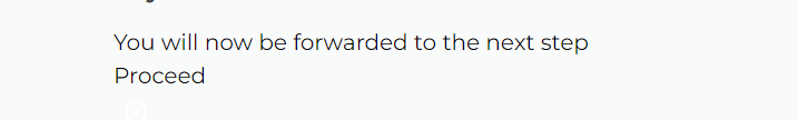

I am getting this block after entering card detail and proceed (checkout page) ; instead I need to display Order Confirmation page of order just created after this; here only after clicking on "proceed" I am landing into Order confirmation page.
Help to skip this page after entering card details ;
Here I am using Stripe payment gateway...
TIA
TIA

By default, the button is automatically clicked by the Javascript code included in Aimeos. That may not work any more if you've change the HTML structure or the CSS classes. Then, you have to adapt the JS code so it works again:
https://github.com/aimeos/ai-client-htm ... #L124-L135
