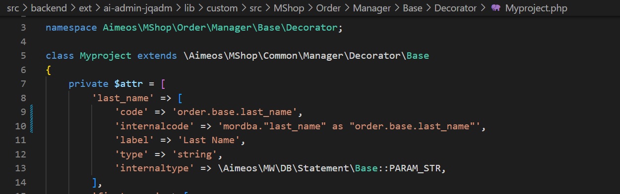

Re: How to extend a mshop_order_base table
I am not sure what you mean only the configuration contains the type of the sub-manager and based on the link.
This how I understand and did it but after php artisan aimeos:setup. No additional field was added in mshop_order_base table.
Please guide how it is done to make it right.
I also tried this way And this and moved the Myproject.php file to
ext\ai-admin-jqadm\lib\custom\src\MShop\Order\Manager\Base\Decorator\Myproject.php

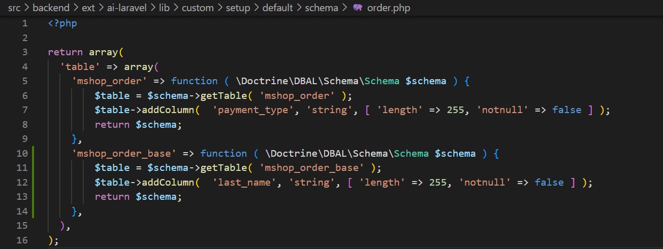

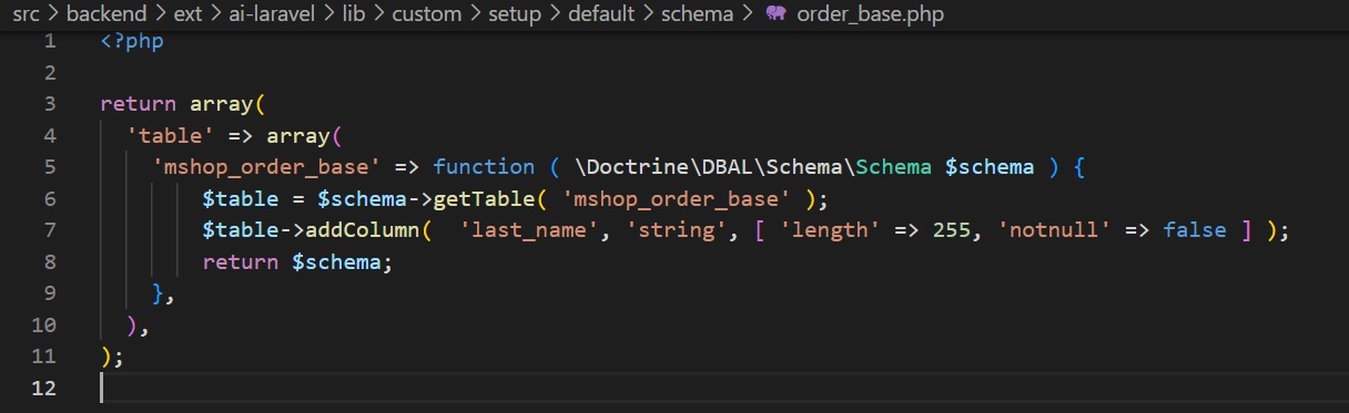

I have figured it out how to add the new columns to mshop_order_base but I couldn't display those added new fields.
Please advise what is the correct configuration to show it in aimeos admin order list page.

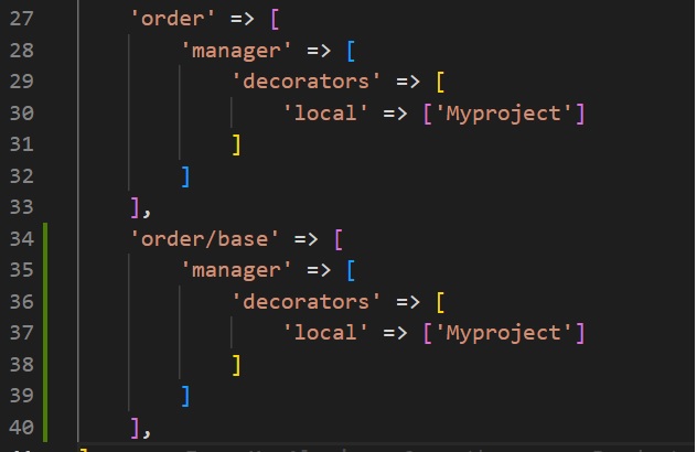

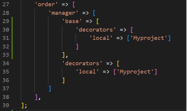

Your schema file is now correct (order.php) but your decorator configuration must be:
See: https://aimeos.org/docs/2022.x/config/m ... atorslocal
'mshop' => [
'order' => [
'manager' => [
'base' => [
'decorators' => [
'local' => [
'MyProject'
- IvanIgniter
- Posts: 58
- Joined: 01 Dec 2021, 07:41
Thank you..

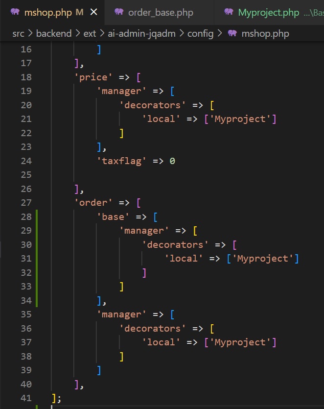

'order' => [
'manager' => [
'base' => [
'decorators' => [
'local' => [
'Myproject'
'decorators' => [
'local' => ['Myproject']
Works for me.

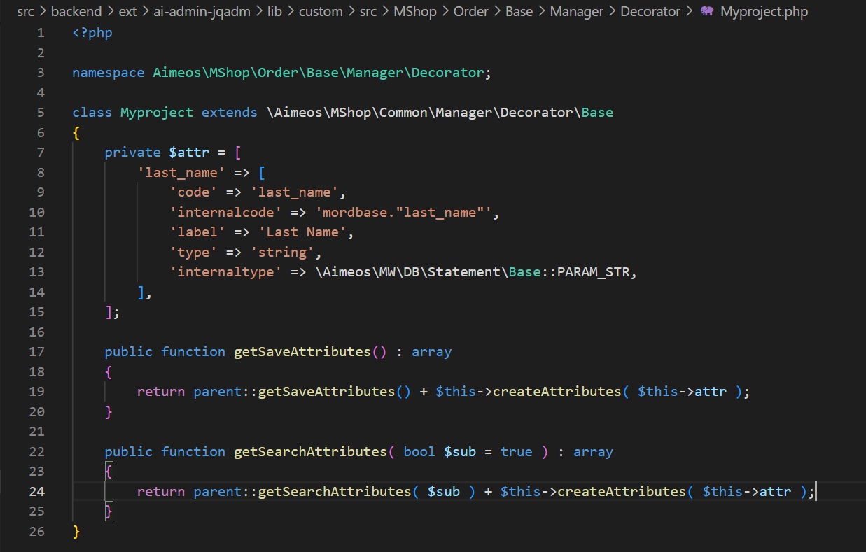

The second mistake was the Decorator/Myproject should be mordba.fieldname not mordbase.fieldname
'order' => [
'manager' => [
'base' => [
'decorators' => [
'local' => [
'Myproject'
'decorators' => [
Works for me.

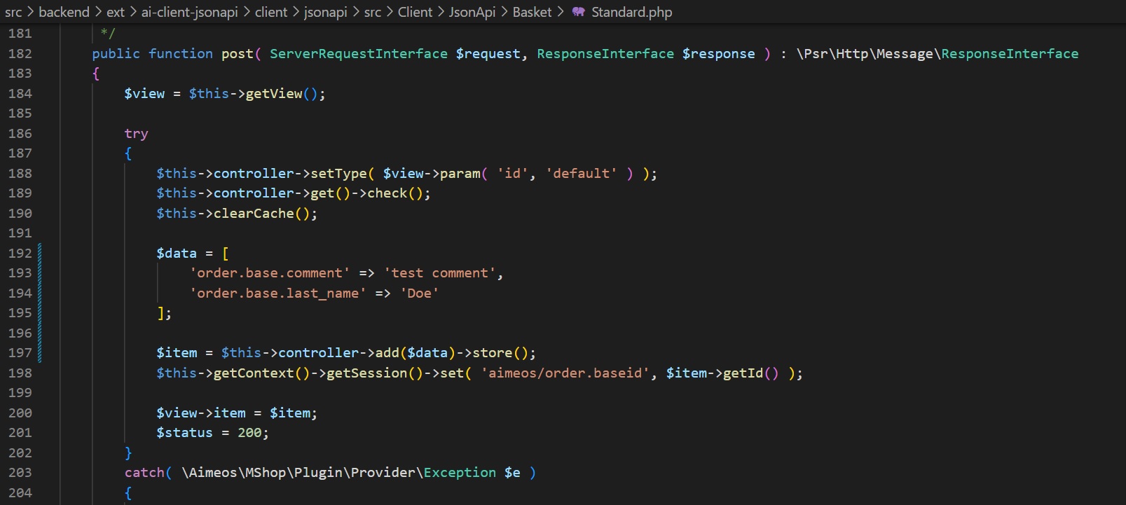

Can I have a last one more question using a decorator.
I was able to display now what records are stored in the db but storing into that extra fields along with existing fields is not working.
Why is the comment field was the only one stored in the db and the new field last_name did not?
I was tracing the whole codes as will as the aimeos core to make it right but I can't figure it out.
- 4a.jpg (90.38 KiB) Viewed 5846 times
- 4.jpg (156.23 KiB) Viewed 5846 times
You must hand over "last_name", not "order.base.last_name". The key is exactly the same as you use in your decorator.
