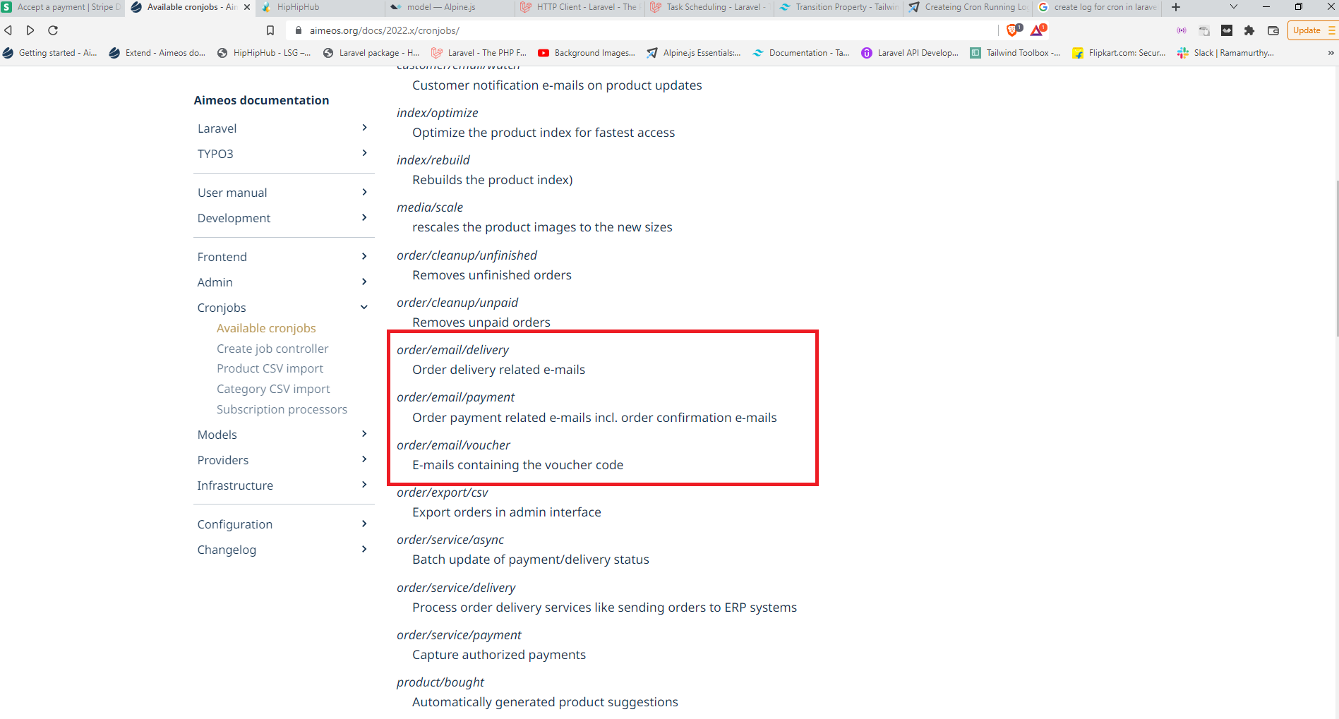

I have attached an image here shows list of available crons in aimeos system; under ai-controller-jobs -> controller -> jobs folder structure I can able to identify all order/service related cron job but there are not order email related cron file; Help me to identify those file;
And after overriding these built in crons where I need to copy these folders in my extension folder ?
help me to identify these;

Guess you are using 2021.10 because the email job controllers are in the ai-client-html package in that version (this changed since 2022.04):
https://github.com/aimeos/ai-client-htm ... rder/Email
